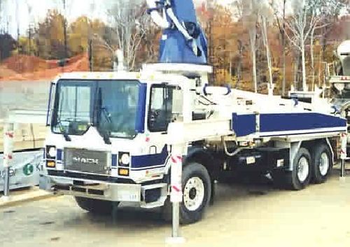

Elkhunter I dont believe they have a "stop" system but they sure increase stability when short-rigging. They can be fully extended without being swung out all the way. Here's a picture of one on a job... (someone elses pump)... |
| TooTall | 12-29-2008 | reply profile send pm notify |
I also like the straight shot deck-pipe with no 45s to the turret and good elevation. |
