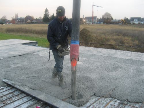

If you want you can watch the short video on my site www.concretepumps.be where I'm driving the hose myself. Feel free to post you're comments on it. I'd like to know what I'm doing wrong?

I cannot tell but I do not think he is wearing safety glasses,if I do get on  the hose I would definitely set an example by wearing proper ppe and showing teaching how it is done correctly us showing it done while operating shows they can do it with cellphones in there ear are whatever else they chose to do,not the example a professional pump company would want to be giving,put the remotes down get a comealong float trowel and become a finisher if thats what your gonna do and get on the finishers payroll, nothing wrong with helping in a safe manner but placing concrete is the placing crews job not the pump company, if pumpers are doing this to take the liability out of a hose man on the end,two men a operator and a hoseman should be dispatched and the contractor should be charged accordingly , just my opinion

Its funny how the Kris leers is so keen on running his own hose. Take a second to look at his pic not even a hard hat or safety glasses, are those rubber boots even steel toe?? for pump operator to think its ok to run his own hose is bad enough already, but without even a hard hat on makes that just plain STUPID. what happens when an elbow or clamps decides to break that day?? leave the hose to the crew and stick to pumping!!
