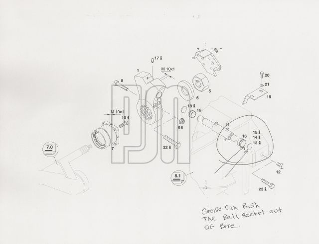

TL the throw of the S-Tube is set buy the collapsed cylinder.
It is easy for grease to be trapped behind the ball socket cup and then the grease will jack the cup out of the socket. With the machine off and the accumulator dumped, look and feel the nylon socket 16 on the parts page to see if it is extended out further on the side that you are not slewing over fully.
Be careful there is a steel spacer behind the ball socket this is the adjustment for the throw, do not change sides on this they might not bee the same thickness on both sides. The thickness is varied when assembled to set the throw.
I chose a random parts page, please let me know if your machine is different.
