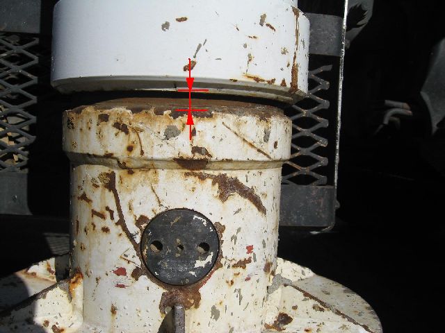

Tiso, here's a picture of the ourigger jacking cylinder, I drew an arrow on the pictures, I hope it shows; I had some that dropped all the way to the ground when parked over the weekend; newer designed cylinder are not doing that anymore

it was when they first came out with the 41M, 2005-2006, the design of the cylinder has been revised 3 times and the latest version seems to be working with no problem; on the earlier versions I changed seals on the cylinders with no success, but be careful if you were to do that, because some of pistons are bolted to the cylinder rod and the bolts are secured with a weld; |

That cylinder creeping must be check valve related. Just replace the seals on the check valve bolt. |

Ti-so, There are many more used 39's availible vs the 41m,so if your looking for a pump your choice will be limited in the used market. Like another posted stated. If you purchase a used pump have it inspected by a schwing authorized inspector before you buy it.It will be money well spent as the inspection report will tell you of any deficiencies the machine has before the purchase so you wont be caught unaware and have expensive repairs after the buy. I personally like the 39's but both machines have there purpose,send me a p/m with your contact info as I can get you in touch with a guy in New Jersey that will be able to give you a more indepth explanation to the differences of the two machines and could help you locate your machine. @Gboom,that outrigger leg drift is not a common problem with 41m schwing machines,It most likely was unique to your machine. Hopefully you contacted Schwing and they provided you with a solution to fix it ?

boom inspector, the drifting of o/r jacking was a problem with pumps built between 2005/2006, I have seen many 41M's with this problem,not just ours, but Schwing took care of this issue, they also took care of our pumps; |
