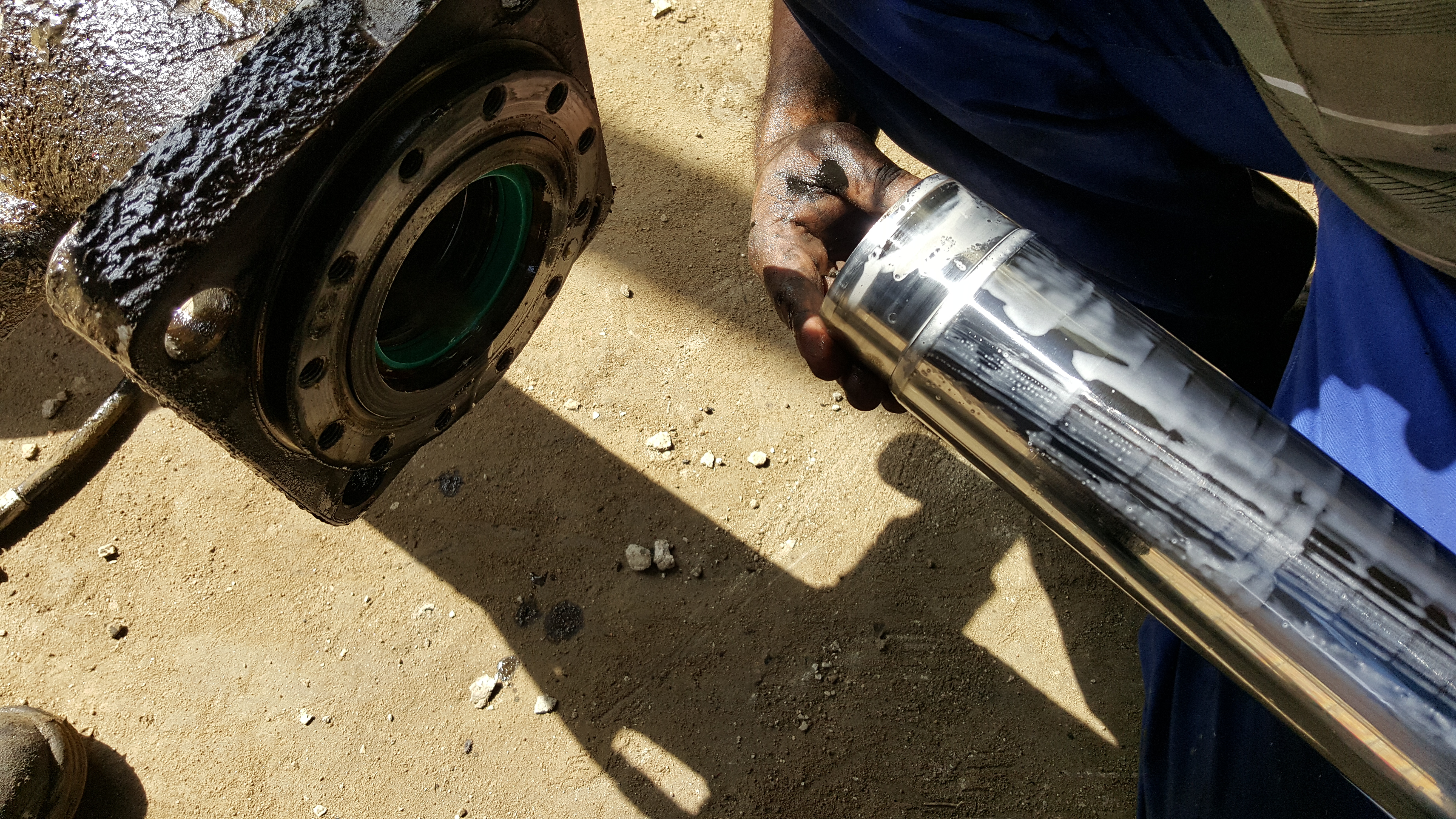

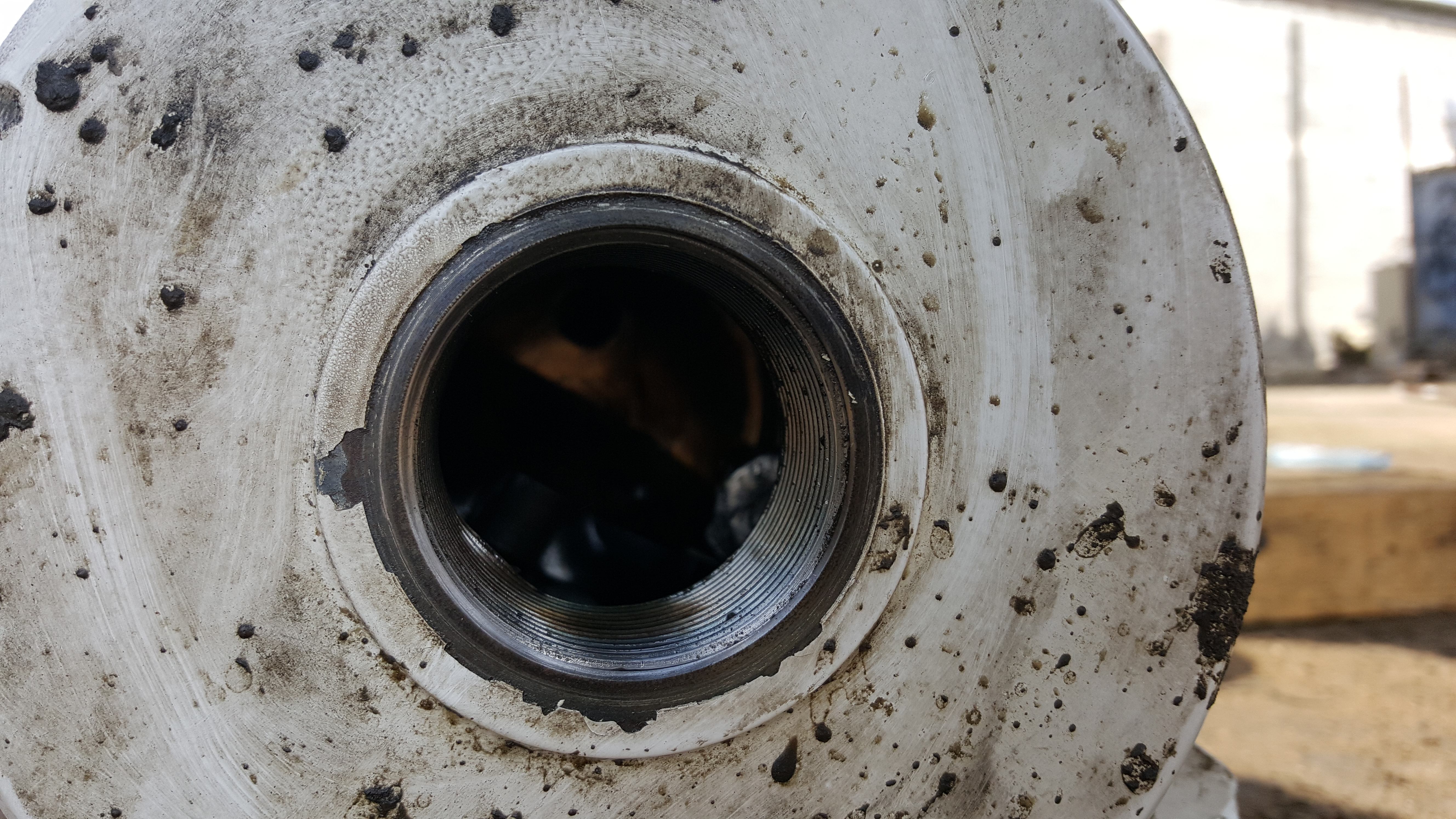

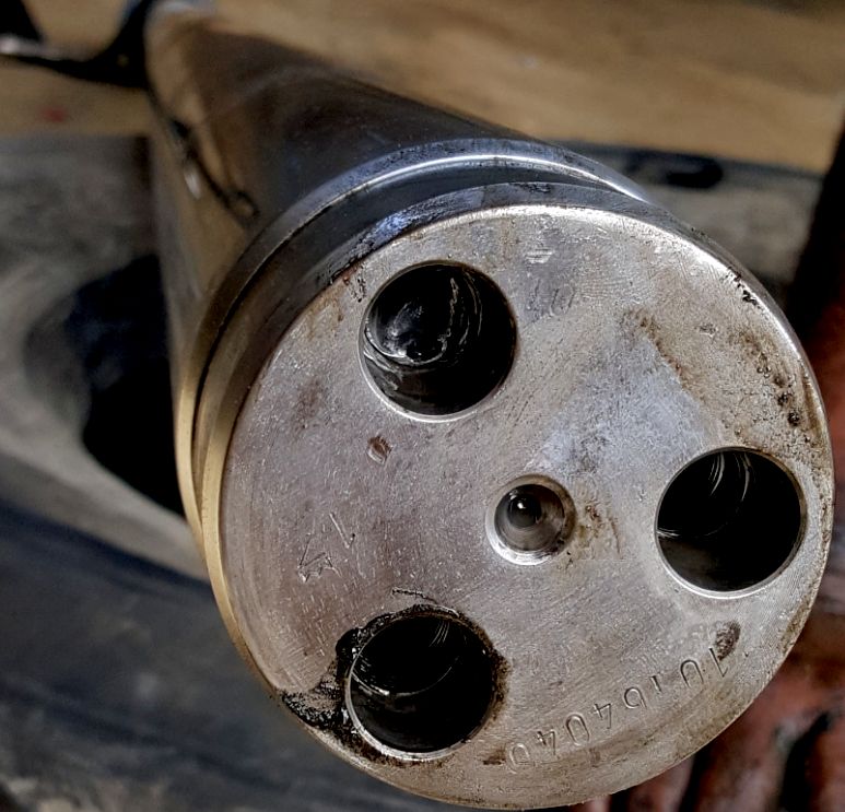

| shady rashed | 12-06-2015 | reply profile send pm notify |
30 something you are right .we found that the Piston rod came out from p iston , one bolt has been Broken and The Thread of the other two bolts have been damaged and the two bolts has came out . it is the first time we see something Like this . Did it happen to any one else? |
some picture for piston and rod , to I have to contact Schwing dealer ? |
another Picture |
| gboom | 12-06-2015 | reply profile send pm notify |
Shady, Not sure what your situation is as far as machine shops or hydraulic shops, but you need to inspect all parts, especially the threads, to see if you can save them. You can contact your Schwing dealer, but if they don't have the capacities to do cylinder repair, you may end up buying a new one |
| shady rashed | 12-10-2015 | reply profile send pm notify |
a compelte differential cylinder we have to replace .also the cylinder has too many scratches from inside .we are not sure why something like this is happened.this isvery strange |
