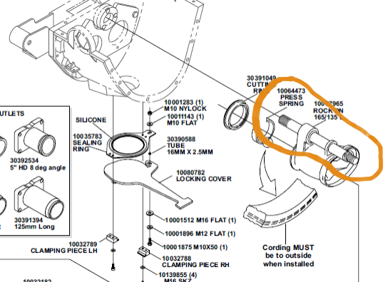

Here is the shaft im talking about circled in the picture its welded into the head of the Rock, if anyone was wondering what i eas talking about. |

you need to replace the complete rock, if you gouge the shaft out, the alignment of the shaft to the rock will be off. that's just the way it is, but all the extra work trying to get the shaft out is not worth the time. when you do replace the rock, be sure to get all new orings and seals |

Thanks very much for the reply, i can get a new shaft from schwing but was wondering was it a big job to remove the shaft and get the new one 100% aligned, so you reckon a shaft and rock complete is the way to go even with the huge price difference of just the shaft on its own compared to a complete unit |

We have replaced many shafts. It is time consuming removing the old shaft but not too bad, and installing the new one according to the directions from Schwing is pretty self explanatory. Haven't had any alignment problems in the past. |

That's sounds promising, I'll ask Schwing for the alignment procedure but as you said its fairly self-explanatory, measure twice cut once as they say, Mark everything before removal. |
