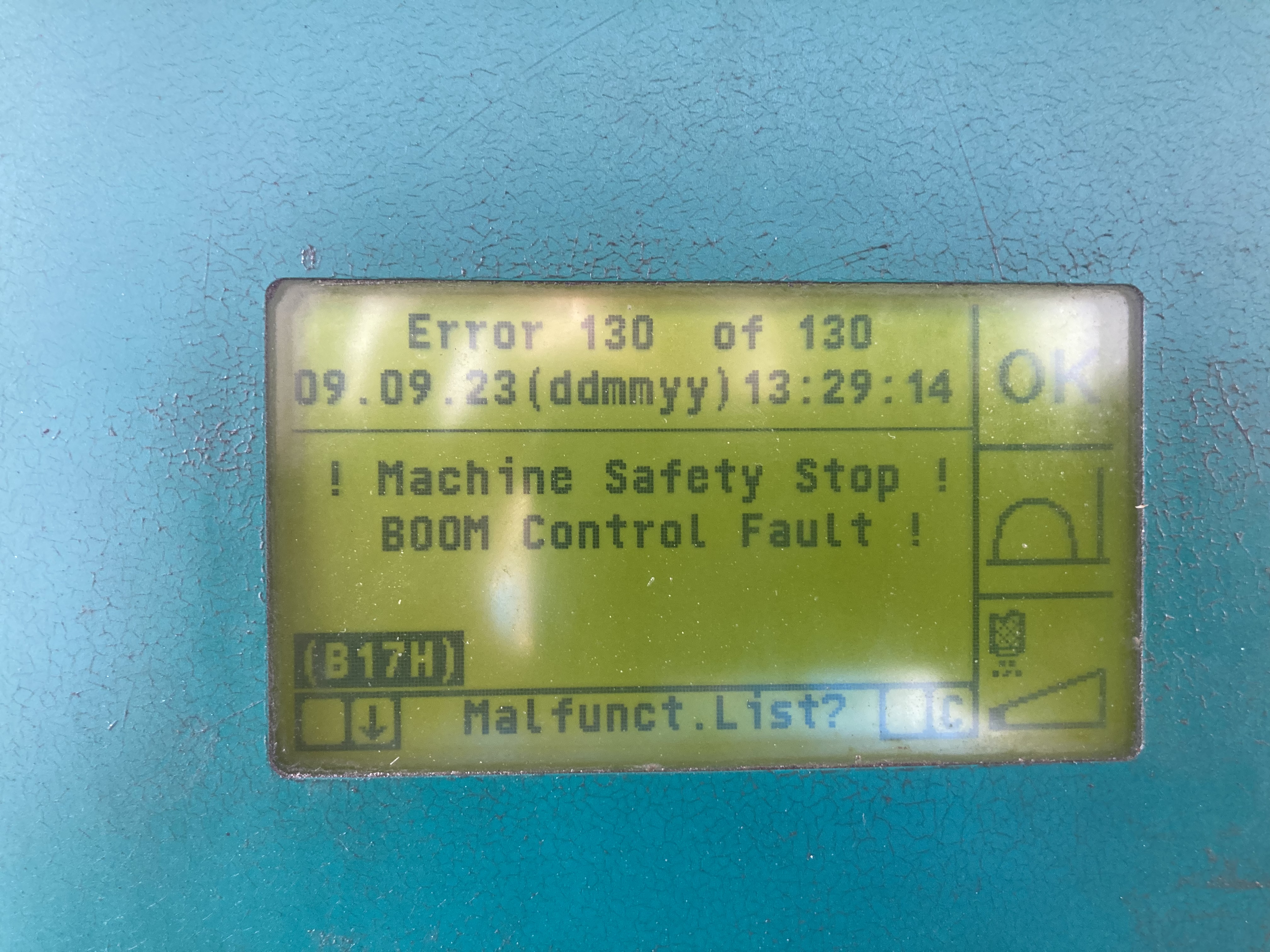

I have a very frustrating intermittent fault which is becoming more difficult to get to the bottom of on our 28x.
We have tried replacement remotes and hardwire remotes to no avail.
The fault has no pattern as to which it follows just shuts the pump system down when it occurs.
It’s possible to clear the fault on the vector and restart pumping and boom movements, the period of time between the next boom control fault  varies between immediately and up to 2 weeks of no issue at all.
Has anyone any similar experience?

Schwing 28X Boom Control Fault Troubleshooting
I can understand how frustrating intermittent faults can be, especially when they shut down your pump system unpredictably. Since you've already tried replacing both wireless and hardwire remotes without success, we need to look deeper into the system.
Possible Causes for Intermittent Boom Control Faults
  1. Wiring/Connection Issues
    • Look for loose or corroded wires in the e-stop switches
    • Check connections in the cable powering the remote receiver
    • Inspect for corrosion in cables (especially if the pump has been washed with acid)
    • Verify ground connections for the control box
  2. Voltage Drop Issues
    • When multiple boom functions are activated, voltage can drop below the threshold needed
    • Each function you activate draws more current from the circuit
    • At some point, the e-stop relay may drop out due to voltage drop, not from a bad e-stop button
  3. CAN Bus Communication Issues
    • Error 194 (CAN bus-off) indicates an interrupt from one of the devices on the network
    • Check if the keypad and display are working properly
Recommended Actions
  1. Contact Schwing Service at 1-888-SCHWING with your fault code information
  2. Have them help backtrace whatever triggers this particular fault code
  3. Open the control boxes and inspect for loose connections
  4. Test for voltage drops when operating multiple functions simultaneously
Since this is intermittent and can go weeks without occurring, it's likely related to a specific condition or combination of operations that triggers the fault.
service1 04-08-2025
Please arrow down and take a screenshot of the other codes so we can see what is causing the boom control fault.
