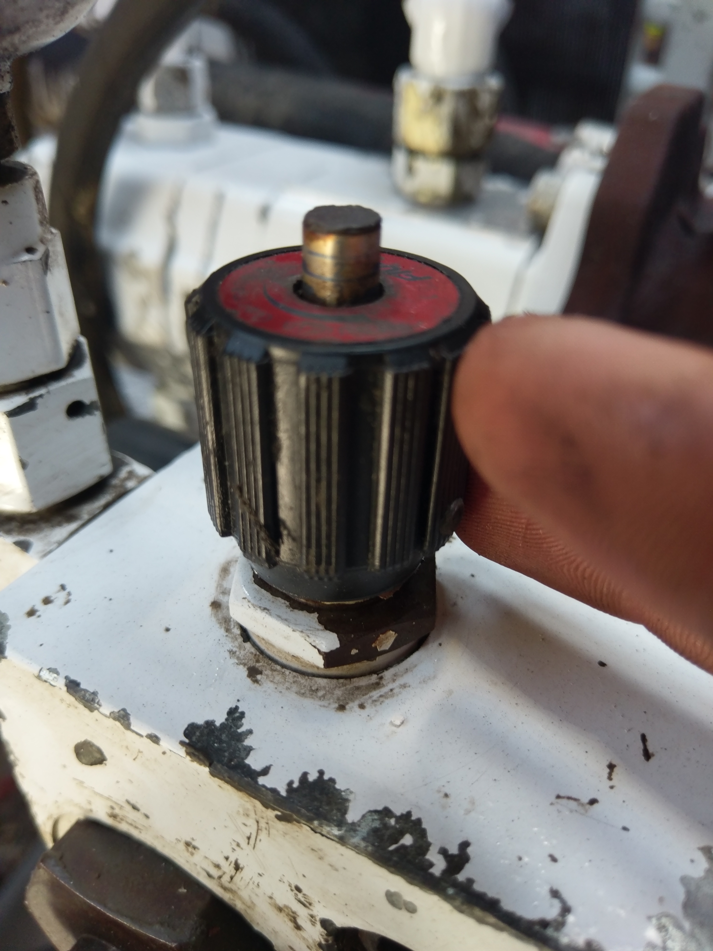

| Niall | 09-29-2017 | reply profile send pm notify |
Thanks very much T-riffic for the reply. When you screw it in and out there is a plunger numbered 1,2,3, depending on how far you screw It in and out, Would you know off hand what the 1,2,3 mean as there is nothing in its operators manual about it I have attached a photo of it thanks again for the help |
| T-Riffic | 09-29-2017 | reply profile send pm notify |
The numbers and marks are just to show what you have it set at I think that is how many turns of the nob so you do not have to count them I usually leave mine about 2. |
