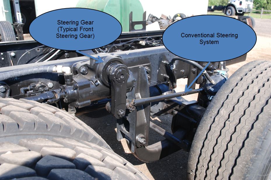

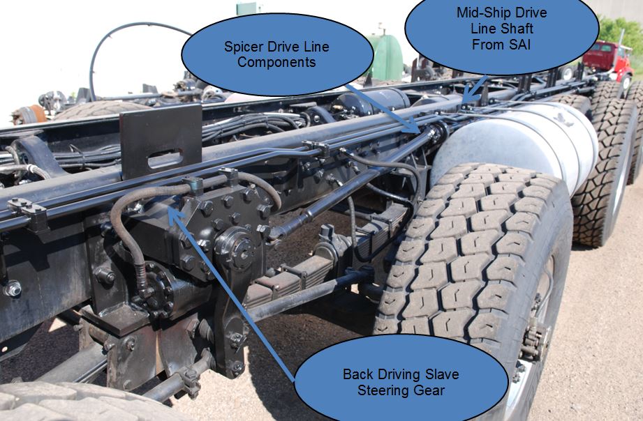

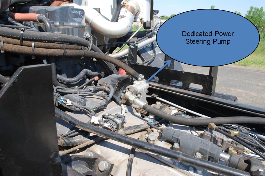

The Schwing Rear Steer System (SRS) is a proprietary rear steer system which applies to a Mack truck chassis that utilizes a mechanically linked, hydraulic assisted solution for long wheel base concrete pumps. The Schwing rear steer system benefits from is reliable simple design that eliminates the delay, and maintenance in electronic systems. The SRS system maintains the alignment of the rear axle and eliminates the play that is inevitable with more complicated systems. There is never a need to manually reduce the amount of steering in the rear axles. Unlike other systems that require electronic feedback, the SRS system has no limits to the turning radius or the speed at which it works. Best of all Schwing rear steer system provides the tightest turning radius in the industry, beating many competitive machines by almost 5 feet (53’9’’ vs 58’ 6’’) |
