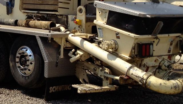

Can ANYONE post a picture of the retrofitted 6-5 reducer on the 58/61m Schwing? I remember it being discussed and really need to see one done! We keep busting clamps, clamp bolts,and brackets!

This isnt a great picture but it may help you determine if there is any difference. If you look dirctly under my pad rack you see the area that the paint is peeling pretty bad, that is the area he welded an extra plate with some brackets on to beef it up quite a bit. He had some pictures on his website of the work he did on my pump as well. Hope this helps

if you have the old set up, with the double 90's and the short reducer, you need to add  two clamps on each end of the reducer, use a u- bolt and weld some bracketry to the tray. You also need to add a clamp after the double 90. We did that and that was the end of our problems. The 3m reducer would be ideal, but there is no room on that truck for that

A u-bolt was added at the 5" end of the reducer.  We also replaced all the clamps and used either bolt ons with 14mm bolts or I found some bolt ons that used, I believe 5/8's bolts and nuts.  Since we did this we have had no problems.  I will try to forward some photos,
This came from Schwing:
One solution GmbH has given us is to use 10.9 bolts instead of 8.8 bolts.  It would obviously depend on where the clamp broke to see if this would work.

that's what Schwing did, they went to the set up, that is shown in the picture

I am guessing he has the old style were the 6-5 reducer lays flat with the 2 90's to the deck
Dont need one 02-01-2013
 AZ pumper look at the picture. Over 33 years I've noticed that manufacures dont do anything until it's brought out in to the open. The 1st light weight 42 meter booms were uncontrolible until they were confronted with the problem. You ever notice the fins on the bottom of a rock valve, before they were there we used to weld bolt's on the bottom of the rock valve to swipe the excess concrete in the bottom of the hopper to keep it clean, just some old fact's.
AZ pumper 02-01-2013
Dont need one go take a look on that black 58 that says western on it and tell me how the reducer lays it is not at a 45. It lays flat and has 2 90's that tie it in to the deck pipe.

Schwing changed the design to the one shownin the picture in 2007, possible that Mudlingers pump was built before that change.
