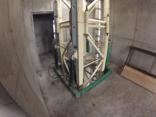

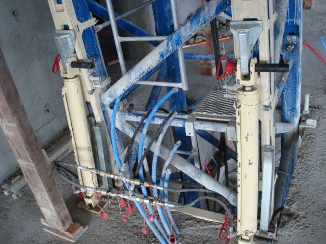

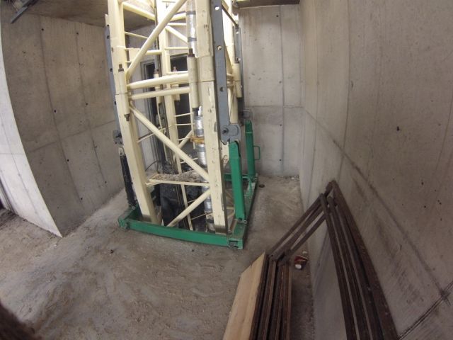

Both Cylinders lift the tower, holding dogs hold it for next lift, Like a rachet.
greenguy | 02-28-2013 | reply profile send pm notify |
Similar pictures for bolt tower |
