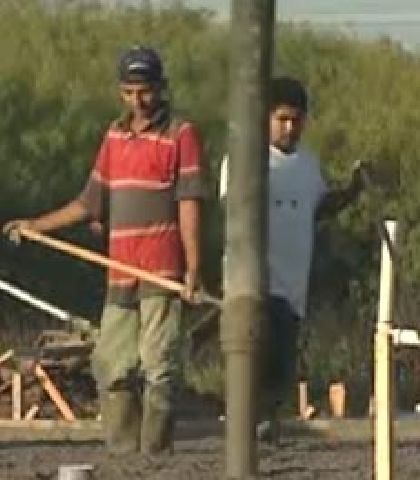

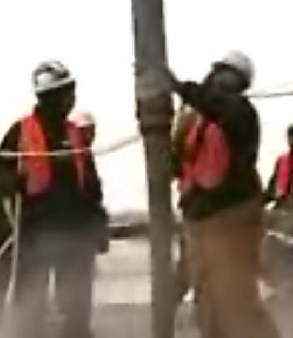

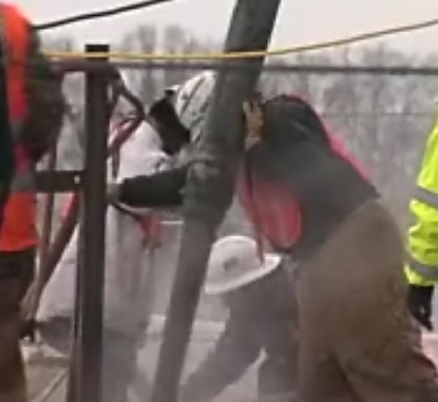

I have seen a lot of bad videos in my day but I am shocked that a manufacturer would put out such an unsafe video. Double end hose, people not wearing safety gear around the hose and on the job.
How can Sermac put out such a bad video to advertise their product. I guess if you run a Sermac you dont have to follow the safety rules?
Well if you guys watch the videos remember Sermac is not following the safety rules.
How can Sermac put out such a crappy video.
Ok so lets count how many safety violations we see?
http://www.sermacamerica.com/view_video.php?id=5
Todd 11-28-2009
Just in case you dont want to watch the videos here are a few screen shots.
