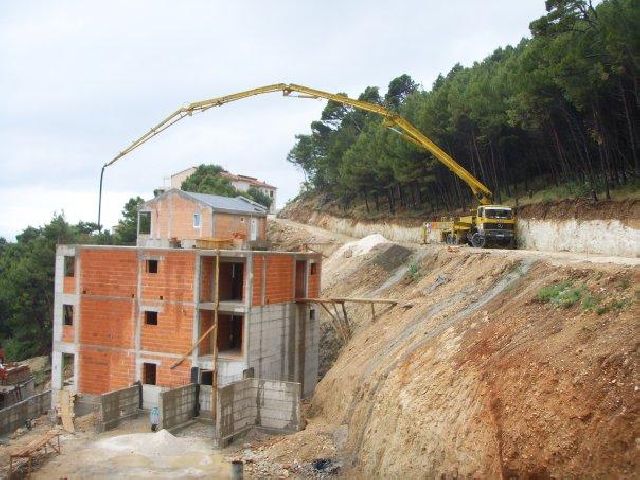

PUMBO | 02-05-2010 | reply profile send pm notify |

nothing wrong with that setup, just REMEMBER where your outriggers are in relation to your boom OR just REMEMBER where your boom is in relation to your outriggers, no need for tape, witches hats or a slap on the back of the head, be an OPERATOR, be FOCUSSED, IT'S YOUR JOB. if it's too hard get another job |
Boom Inspector | 02-06-2010 | reply profile send pm notify |
damn PUMBO , was that your set up ? Man you fellas got some brass balls for real, not saying weather it is good or bad the picture just looks terrifying for some reason. lol pretty cool picture thanks for adding it |
mothy | 02-06-2010 | reply profile send pm notify |
wheres the one to one rule |
Telealbelt | 02-06-2010 | reply profile send pm notify |
I suppose I've done pours like PUMBO's but I'd have to think twice about posting a picture. My insurance company might be watching. Just kidding nice pic PUMBO |
Justapumper | 02-08-2010 | reply profile send pm notify |
Nice set up Pumpbo, looks like some I have had to do. Mothy that is a sloping cut and it appears to be a very rocky soil and, he seems to be sitting on a limestone shelf. Up here in N.Az I have alot of sites on pure rock with sloping cuts like that. You always have to assess your soil conditions even when not short rigged. Short rigging is never a problem when you remain aware of the fact you are. Me personally Im never fully relaxed while short rigged and, dont relax till Im folded back up. I mentally keep myself on that edge, that is what works for me. |
