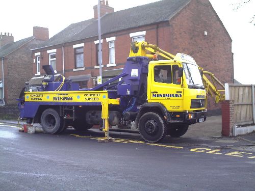

Todd | 11-30-2008 | reply profile send pm notify |

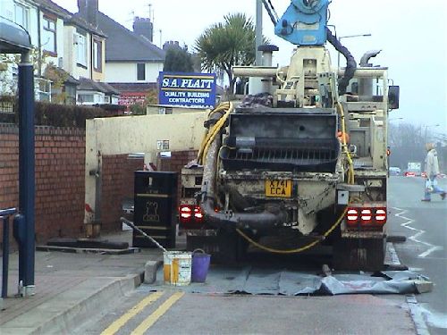

Is that your pump or one of your competitor’s pumps? |
minimicks | 11-30-2008 | reply profile send pm notify |

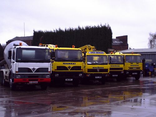

hi todd,yes this is are own pump we run that and a 16 mtr and 5 concrete mixers and 1 artic |
wow, it got me thinking, what would it be like if you knew your competitor was taking pictures of your bad set up and posting it online. lol I dont know if its a good idea or a bad one but it is an idea. |

BAD idea. if i see a bad set-up or something leading to trouble, i stop what ever im doing and ask the operator what he thinks of the set-up. if he's none responcive call his office. im sure they would be happy to be informed from competition then an OH&S officer. I for one will not post any pic of other pump and a bad set-up. I will post pic after the pump has fliped. |

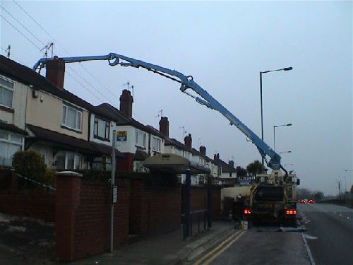

wow! Todd i had to look at that pump a couple of times. If that pump was in the states i would swear that it was one from the company that i work for. if you look at my pics the boom is identical. i would even go so far as to say that it is an identical 38z boom as what i run on highrise. |
Bob | 11-30-2008 | reply profile send pm notify |

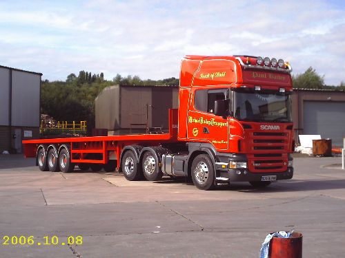

THIS IS ONE BADASS TRUCK !!! |
Vasa | 11-30-2008 | reply profile send pm notify |
Yes Bob , a SCANIA from Sweden.... |

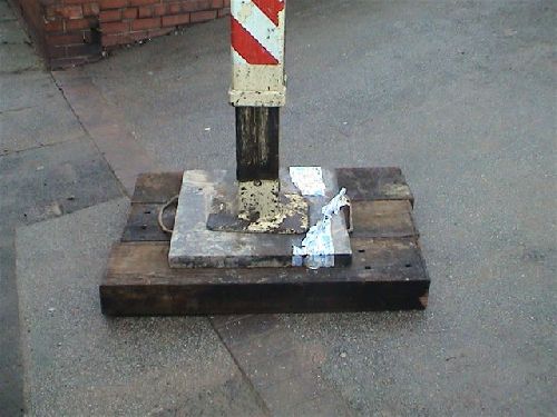

Actually as far a setups go I think this is a good one. I hate short rigging but sometimes it is your only option. When I short rig I really make sure my load bearing side is stable, lots of dunnage even if the ground seems stable. I know am stating the obvious here, but these are times when the operator really has to be on his game. Stay in your range. No forgetting that you are short rigged and then swinging around to pump back into the mixer. By the way...what are some people's opinions on this? I have heard that you can swing around to the back of your pump, a -framed as long as you don't swing past the center of your pump, thus putting weight on the short rigged side? I'm not trying to start a safety war here just want some opinion |
It is no problem to do that , as long the endhose don´t pass the shortrigged backleg . Not on a Schwing S42SX , 34m 32m or a Schwing 23m.... And another brand who start with a P works fine to from 20m to 46m....Havent tested no bigger but as long You are "inside" the square of your supportleg with the endhose it is no problem , but I´ve have not tested this on a "overhead roll and fold".... |

Looks like someone got a great deal on a 36z from the US! |
Raymond | 12-01-2008 | reply profile send pm notify |

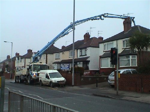

A good deal for sure, Joey. Especially with the Euro/Dollar exchange rate. Short rigging isn't the most ideal way to set up, but if done properly can be done safely. However, shortrigging the working side is just plain stupid. I don't know if this pump is a 32m or a 36m. The 32m has a samaller outrigger stance than a 36m, so I can't make a fair judgement on the rear outrigger in these pictures. To me, the rear leg looks like it isn't all the way deployed--and that's if this is a 36m. Could be the angle of the picture - I don't know...and it may be a 32m??? Here's a picture of a 36m with the rear outrigger all the way deployed...What do you all think?
minimicks | 12-01-2008 | reply profile send pm notify |
the leg is all the way out its only a 32 |
pudg | 12-01-2008 | reply profile send pm notify |
all the dunnage in the world want help if you boom over a shortrigged outrigger |
Thanks for the clarification! I thought it could be a 32m but wasn't sure.

Is it just me or are those power lines? in the 1st pic |
ShortStik | 12-01-2008 | reply profile send pm notify |
wesdogg, good eye. they could be phone/cable lines but still...1 amp is enough to give you a good jolt... |

not sure if the first picture mite an illusion as in the 3rd picture there not there..due to the different angle |

minimicks | 12-02-2008 | reply profile send pm notify |
your right they are phone cables but there was about 15 - 20 feet of clearance, |
