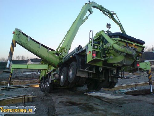

Shortrigged on pumping side!!!!!!!!!
Tiago40m 01-17-2009
Ok if everyone talks aboout my set up then i must say something about this!!!
Just going tru some websites the other day and came across this...
Is this pump really shortrigged on the working side???
Hey operator i know you are on this website, i dont want to create any problems but i think this is a little bit over the limit!!!!

Left front looks short to me too.  Nice eye.

AH he's fine! It wont flip all the way over, It'll just lay over and lean on the builing? What a dumb a$$!
truckshow 01-17-2009
what's up with the tip section??  Looks bent or something...  No excuse for shortrigging like that too... Nice find Tiago.... I hope that operator identifies himself,     I 'd love to hear the reason for this one!!!

Here's what happened when he short-rigged the back out rigger. Actually where is the back out-rigger? It was'nt even out, only down!.....again.....what a dumb-a$$!

I have to disappoint you but it's not my pump and I'm not the operator. I just went to Dublin to take a look at the pump and I took some pictures. And indeed, he's shortrigged on the working side and I can't see why because there is plenty of space on the other side.
Truckshow, it's not the tip section and it's not bent. It's the third section in a 5 section boom and it's the way it's made in the factory.

This guy does the completly opposite, fully extendes the outriggers on the unweight side????? and shortrigges the working side. I dont understand, theres got to be more to this story........

tiago, you think there would be be but lookin at the pics,  its a drive in and setup as is.
I find it facinating how the "dead" side has fully extented outriggers.
kris, you are alot braver then i am.  i would have not bee anywhere near that pump.  i would have said my piece, called a taxi, called WCB/OH&S if no body would listen.
those are either balls of steel or a scull of lead

I think the driver just misjugded the distance of the outrigger and didn't take the time to move the pump a little bit.
He did take the time to fully extend the outriggers on the opposite side but as you all know, in Ireland they even drive on the wrong side of the road...

it is setups like this one that will get you the 15 min of fame that you dont want. hey kris by looking at your pic not only is he short rigged but there is no dunnage and the front drivers outrigger pad is buckled up. the operator may have misjudged but it looks to me like he was in a rush or just didnt care. i beleive that this operator deserves whatever CONSRUCTIVE critisism that they receive. an extra 20 min to set the pump up right and these pics would be recieving praise not being ripped a new one for a bad setup. RUSH SETUPS AND PURE LAZINESS KILLS, GUYS!!!!
