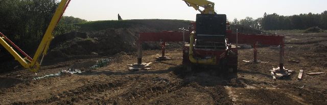

Here is one this soil was so crappy that it took 45 min just to get the truck stable enough to pump there was a D9 on site to pull in the mixers I was pumping storm run outs close to 160m if I recall on both sides The pump when it finally was ready and secure was eating concrete like Fred Flintstone was eating a bronco burger....lol |

Well this is a situation where I just would have said no. Let them get some steal plates to drive on and some crane pads for your outriggers. You know. when there is no other option or litlle space I like to go far to help the customer but this is just plain lazzynes and cheapnes. They want you and the mixer to destroy your equipment because they want to safe some bucks. Then for me they can go fck them selfs. |

Yes telletuby. I agree with you. If you know how I normaly talk on this site you'd know. But just this situation is going to far I think because it is so totaly unnessasary. Specialy the fact that he has to drive in to the mud and risks to get his truck burried in the sand flat on his stomage. Ok. the dunnage we can fix ourselves but at least the can fix us some kind of road to drive on. |

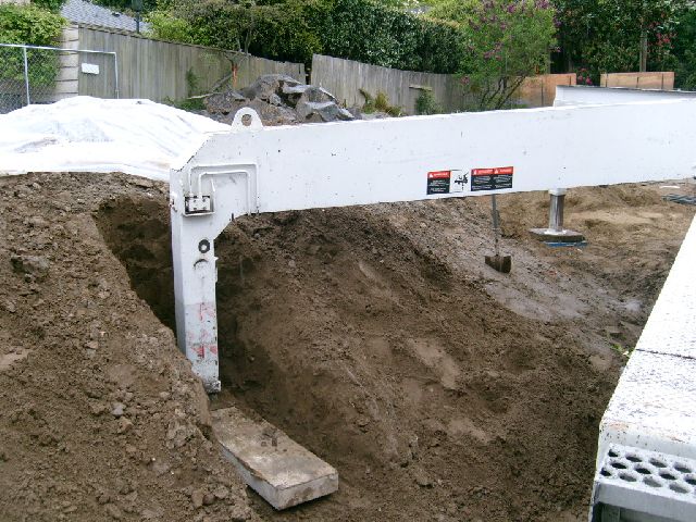

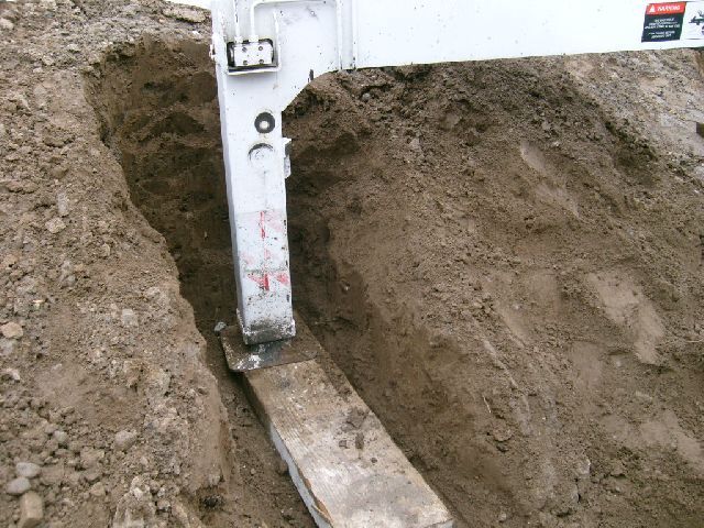

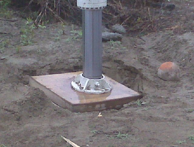

Here's pictures of some soft soil conditions I entountered this spring. This is the opposite of the working side
pumpjockey | 09-29-2010 | reply profile send pm notify |
Here's my working side pad: |
I love working on fill, NOT!! Contractor tells me: "I compacted it with my Bobcat, my pickup doesn't leave a mark." The fill came from the basement excavation and the little extra from creating the walk-out. About 3' of fill. The outrigger (right rear) that sunk, had stopped there during set-up before deploying the boom so it was pretty much at the maximum loading it would see, and I swung the boom away from it when unfolding. The pictures were taken with the boom in pour position, pretty much directly over the super-sized 42x42 pad. |

I always try to prepare my non-working side just as well as my working side. There are to many what It's that could cause the boom to go over that outrigger. Whether it be operator error or equipment malfunction. What if something suddenly goes wrong on the working side and you must quickly swing to the non-working side? What if you swing to the back of the pump to suck back the sponge and the outrigger on the non-working side becomes slightly loaded and can't sustain the load? Its better to take the extra time in the beginning. It could save alot of trouble! |
Funnyboom, that's always a good idea, but using that logic short-rigging would be taboo as well.
Do you ever exceed the speed limit? How about even to pass another vehicle. Ever tell a 'white lie'?
You do what you gotta do, as long as it's not reckless. Therein lies the rub, it's a judgement call. |

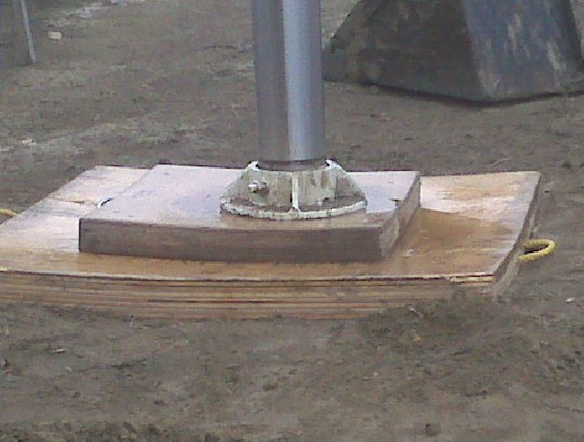

Gotcha Muddy, one thing I used to do is to drill holes in the end of dunnage and put 6' ropes on it and leave the ends strung out. When I got done with the job, I could use the outrigger to pull it out or get a tractor if one is available. Just a thought. |
Put some heavy plastic sheeting down, so that you don't have to break the strong suction that the mud creates. |

There is a huge difference between shortrigging and not putting out enough dunnage pumpjockey. I only shortrig when it is absolutely necessary! People only fail to put down proper dunnage because they are too lazy or they are rushed or they can't find any, whichever reason it may be they are all bad excuses! There is never a good excuse for inadequate dunnage for soil conditions. |

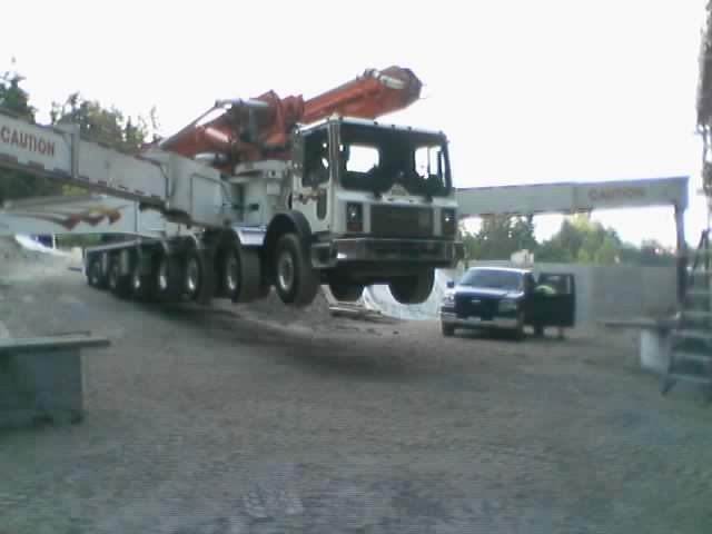

SUPERDOFFER | 09-30-2010 | reply profile send pm notify |
Some contractors learn it the hard way some don't take the risk

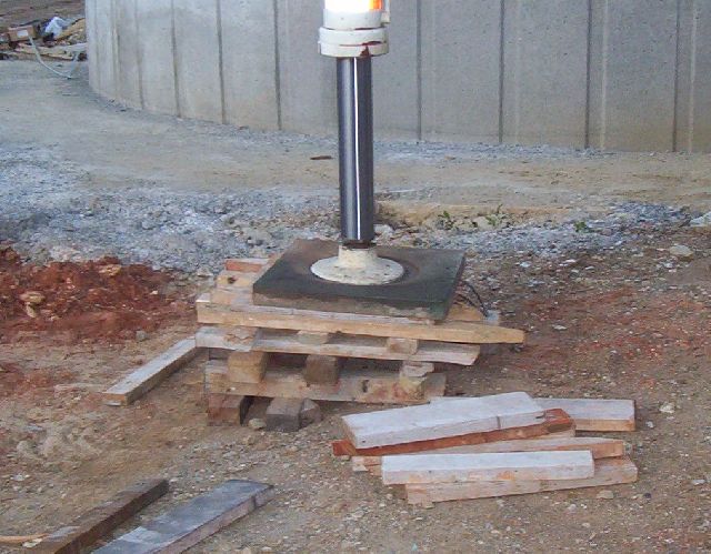

bisley57 | 09-30-2010 | reply profile send pm notify |

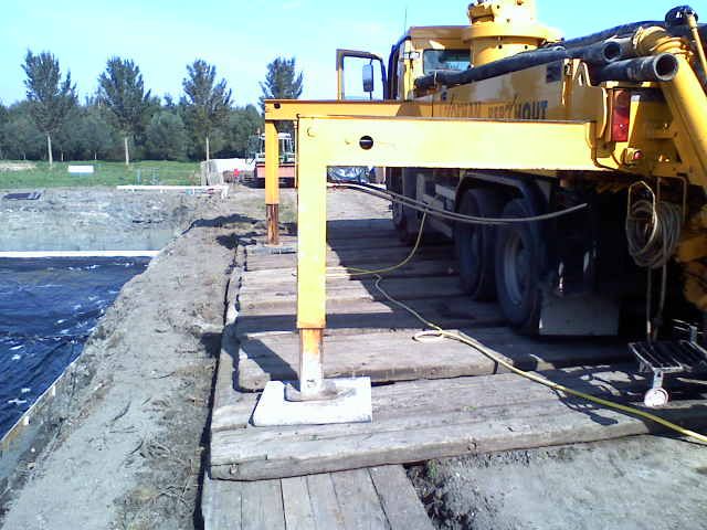

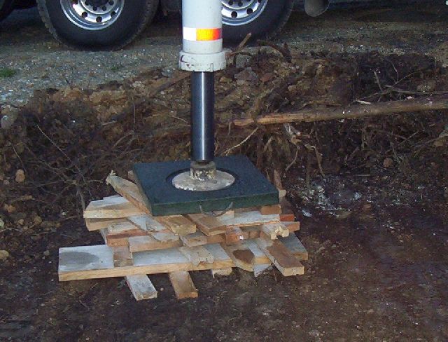

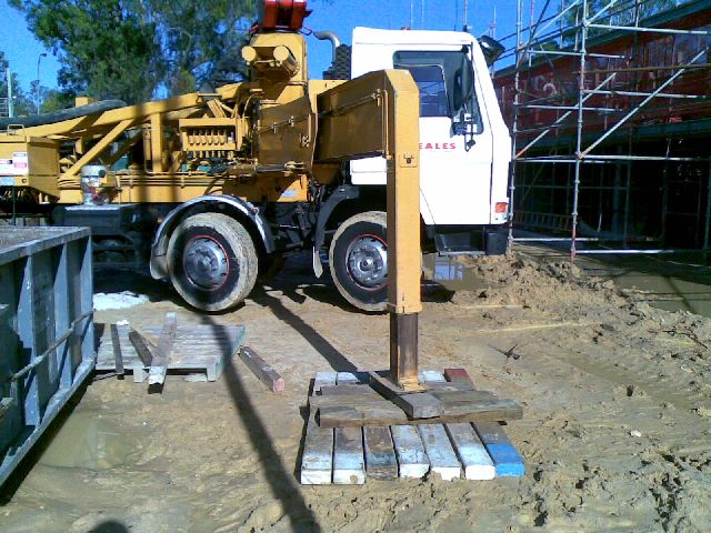

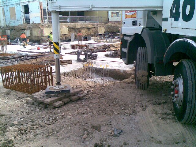

Some of the dunnage pictures surprise me |
pink panther | 09-30-2010 | reply profile send pm notify |
I see it too many times with dunnage that has voids between the lumber, like in the pics form Pour it out. Not picking on you but that is technically illegal and not to mention, UNSAFE. There are not allowed to be gaps like that. Especially with those 2x4s |

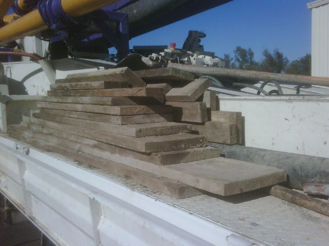

we carry four of these ( three 48" 4X6's glued and lag bolted together) on all of our pumps 24-40M, as well as four 18X48 DICA mats. and use at least two of each under all fully loaded outriggers, Worksafe actually comes around to Job sites with tape measure and calculator in hand to inspect that proper dunnage is being used for the given ground conditions. And generally what they are looking for 1600 square inches of 4X6 or larger timber on a 32-40M pump... 2X4 and 2X6 is frowned upon... and using only 24X24 pads on all but the absolute ideal ground conditions will get one written up... generally I think it's probably a good thing for the industry.

Yes no gaps, In the crane test, they call it bridgeing. |

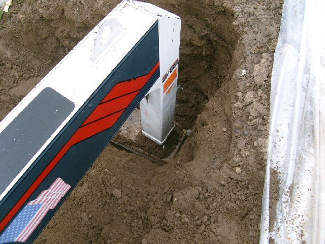

Todd | 10-01-2010 | reply profile send pm notify |
northwest63 | 10-01-2010 | reply profile send pm notify |
TooTall | 10-02-2010 | reply profile send pm notify |
That looks familiar Todd? Oh yeah cuz I had to dig that freakin hole!!! |

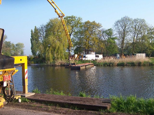

Dipstick | 10-06-2010 | reply profile send pm notify |
Ok. Just to join the funn.. |
