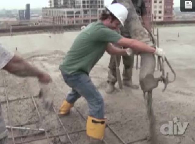

isnt the porpose of running an s-tube or double 90 on the end hose to make it not splatter and come out slow. looks like it was splattering alot. And if they were using that thing to control air loss, than why would they let their column mud fall 12' really liked how he was pusing the hose as far as he could talking about how much forse the hose has, yet didnt think about the decapitation that could happen in the blink of an eye. |

| pumpjockey | 08-03-2009 | reply profile send pm notify |
Thanks for the video capture, Todd. That's a 5" death mace on the end there, with as little of a direction change there is, it does absolutely no good in slowing the flow down, but it would do a hell of a job to clear a guys head off! |

man has no idea of the danger of that setup.he's not a hose man at all.just someone doing a story.good thing he lived to tell it |

Double-ended hose, with a double S elbow. This combo is not allowed, and is deadly. The contractor supes are beginning to take note of double-ended hoses; many are not allowing them for end-of-boom use anymore. Education is key. Operators, please keep telling them, sooner or later they listen. |
