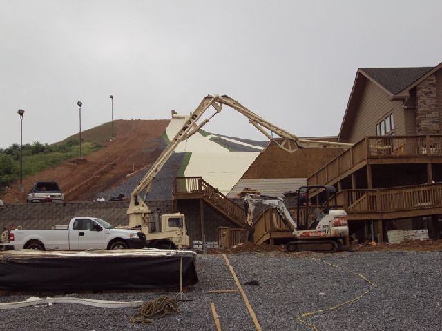

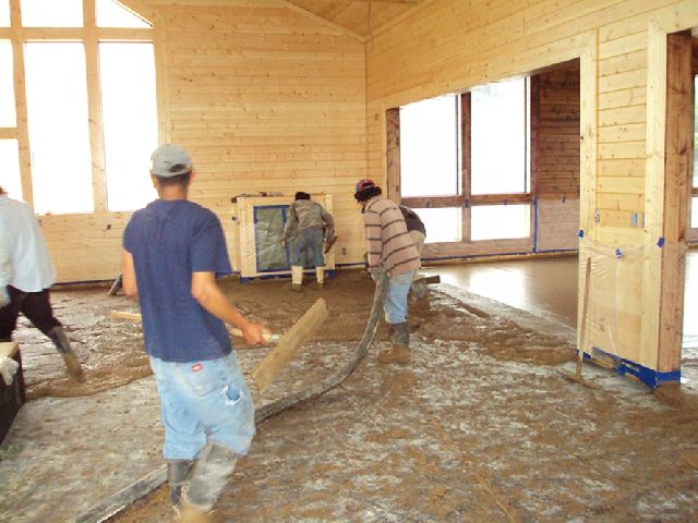

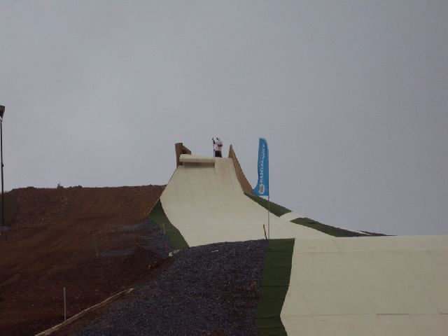

These are a few pics of the new Snoflex at Liberty University,, This is the 1st one built in the United States. They are very popular in England and other countries over seas. This is a pic of the inventor Brian Thomas |

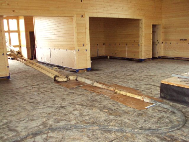

Pumping 2" topping lightweight thru 2.5" hose, brown colored concrete, YUK!!! Learn more about Snowflex at |
