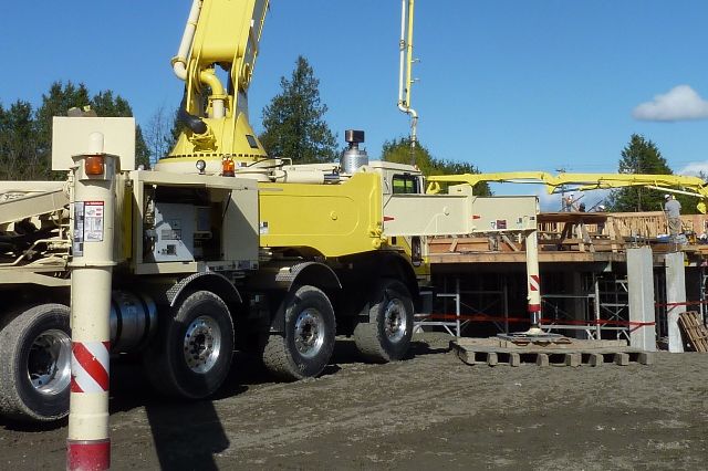

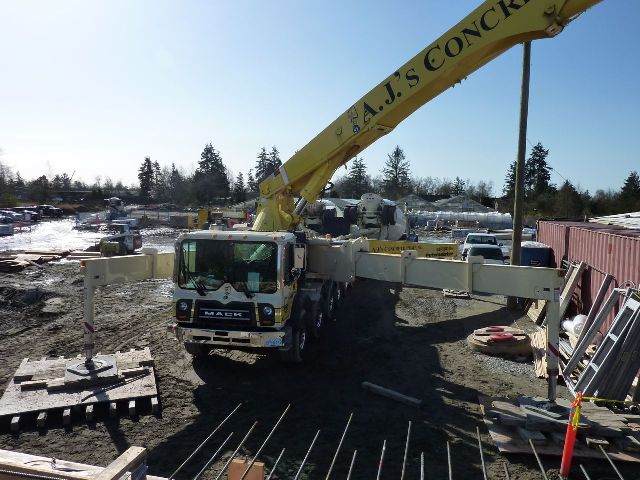

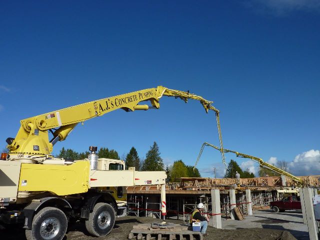

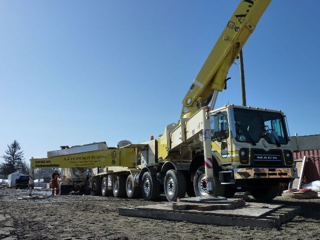

Yeah, that is a good dunnage pad, but a fat lot of good it does on a short-rigged outrigger. Not only is that passenger side outrigger not fully swung out, (which may not be so bad) it's not fully extended.
You compromised your stability over the front. Once you swung past the driver's side front outrigger, without the other front one at least fully extended, your footprint effectively gets smaller as you swing to the right.
If you'd have forgotten yourself and swung too far you could very well have ended up like that Putzmeister in Hollywood |

I have to agree with pumpjockey oss or not what was the point of short rigging the front outrigger? I realize it's ok per manufacturer but everything that is made by a man can and will fail at some point. I guess this would not have been my first choice but I would like to hear why it was yours.

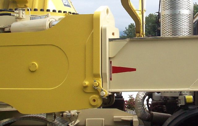

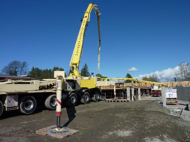

ah ha!... I figured this may raise some concern.... Putz 58RZ actually comes equipped with a pin to lockout the first stage of the telescoping four stage outrigger (look very closely at the pic. below) when setup using OSS, which does utilize limit switches to keep the boom slewed within and safe working range, it is fully documented in the Putzmeister manual and approved for a 180 degree working range... as for why I chose OSS rather than fully rigging the front end... if you look at the ground conditions closely you will notice a sharp elevation change right about where the fully deployed stabilizer would sit (I actually had the riggers fully deployed when first setting up and requested a machine to move the dunnage because as it was right on the edge of the embankment, wanting to obey the 1-1 rule I decided to go with the fully-approved and documented OSS setup and set the outrigger further back on stable soil.
Excellent eyes and I appreciate the concern, but I think sometimes we should ask questions and hopefully learn from each other rather than jumping to conclusions and making accusations. |

OK, that's why I added my second post about the OSS. If it were me, I'd have re-positioned the truck further back and tighter to the C-can, so that the passenger side outrigger could at least have been fully extended, even if it could not be fully swung out to it's widest position.
But at least you can refer the OH&S investigator to the manual when it's laying on it's side. LOL |

Too Tall, really poor ground conditions where the fully deployed passenger side outrigger would site, ground was not compacted in the far corner, I totally understand where you are coming from though.

notice the three dowels towards the front of the first stage, there is a plate that is removed and and pinned over top of the two fowardmost dowels which in effect, locks out the first telescoping stage of the outrigger. |

16 cell. Great picture's. . I run a 63 Putz which has oss and also the lock out pin you've mention'd i've been set up useing oss flat stick over the cab just like the book says and it's steady as a rock the limit switch's do the rocket science for you. If you take a look at some of my old post's you'll see some good shot's of oss in use. Well done keep them picture's coming. |

keep in mind that because the unit is equipped with sensors that will stop the boom from being slewed outside of the SAFE working range, this does not mean that the operator is to blindly swing the boom in any direction without still monitoring exactly where it is in relation to the manufacturers predetermined working range. Between the electronic safety stops and a little common sense on behalf of the operator I would almost venture to call this a redundant setup... which is more than I can say for most any other operator controlled function in concrete pumping.
as a side note, it is clearly stated in the Putzmeister operating manual that you are to slew boom a full 180 degrees with OSS engaged to test that the safety stops engaged and operating properly before fully unfolding the boom and loading the outriggers... this is to be done EVERY single time the pump is setup... You are fully entitled to your opinion, I personally choose to utilize this system on a regular basis and am extremely happy with it.
