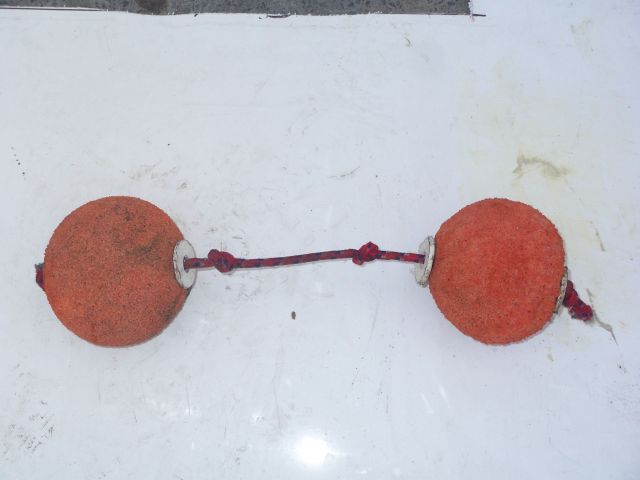

| Tom @ Irving Eqt | 07-11-2012 | reply profile send pm notify |
What's pictured with 16 cell's reply works especially well on the booms with two different ID systems (4.8" & 4.4" for example). Sending through an individual ball on those will want to 'jump' at the ID size transition & leave a build-up that may not 'hurt' tomorrow, but over a weekend can bite you big-time at prime-out on Monday morning if you get my drift. There's also a 'Blue Go-Devil' that works real good on 4.8"ID pipeline. It's made from a silicone type compound & the center is very much hollowed out so it will go around the tight boom 90's. This thing acts like a 'squeegee' on the ID of the pipe & does an excellent job of cleaning it up. |

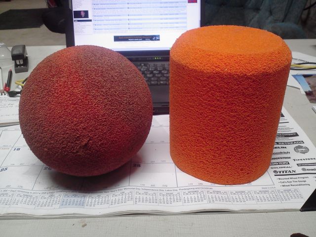

| cp | 07-13-2012 | reply profile send pm notify |
for a normal clean out we boom down, fill reducer with water and insert ball on the left.... if it was a real nasty mud we use the cylinder sponge on the right (it actually works the best 90 percent of the time) if you pay attention to cleaning the critical areas its a real good system. i cant imagine how only a water wash would get mud with 2 percent accelerator in it completely out of the boom!? are you crazy? |
