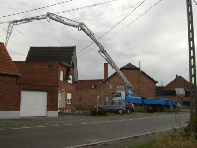

Mr. Wibau, in the picture you see I'm not going over the powerlines. Often it's very hard to tell from a picture how far away you are from power lines. In this case I'm not even near them. If you look well, you can see I'm standing with the pump behind the pole holding the lines. The lines are going to another pole on the side of the street closest to the point of view of the camera.  I'm going with the boom to a house on the opposite side of the street.
Also the power lines in this case are isolated. In Belgium mostly the lower line is an isolated line used for cable TV. The upper one is an isolated powerline.
Sometimes, we have some older lines that are not isolated and then of course you have to make sure to keep the prescribed safety distance.
The really high voltage lines are not isolated but they mostly are hanging a lot higher. Even though, sometimes the're in your way. In that case I rather keep the boom down and put some extra pipeline instead of risking lives.
About holding the 3" hose in your hands or with a chain and your foot on it: I still prefer they keep it on the ground but the safety, in my opinion, depends alot on the experience and skills of the pump operator and hose man. If the hoseman can notice a problem in time he can prevent injury and damage. If he doesn't really know what he's doing, he can, in case of an air pocket, point the hose in the wrong direction as well with chain as in the hands. The severe consequences we all know. For those of you who've never seen it happen, I recommend to check out some safety videos on video.concretepumping.com
A concrete pump can be a dangerous toy, so we better try to keep it as safe as possible.

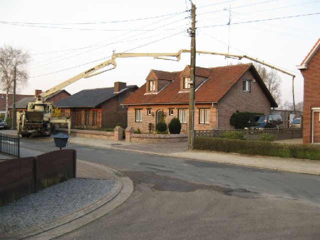

so ypu are telling me you are not going over the power lines here hey? fair enough i must be seeing things.
as for the hose i guess everyone to there own.
Kris Leers 04-04-2010
Yes indeed, on this one I'm over the powerlines but as I told you in the previous post, in Belgium most powerlines are insulated and so are these on the picture. You could  take the lines in your hands and you would feel just the same as taking the power cable of your television in your hands.
We also have lines that are not insulated. In that case: stay away from them at least the prescribed safety distance.
Even better: don't get near them at all so you can't make a mistake in judging the distance.
By the way Mr. Wibau: always great pictures you post.
biged 04-04-2010
I hope you know that the weather will destroy insulation on  wires in time so becareful

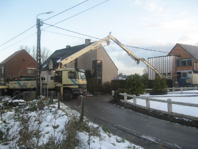

For me, the issue with booming over lines is the ever-present force of gravity and the possibility of a failure of some component of the boom system, whether mechanical, electronic, hydraulic or structural. Gravity will ensure that it comes down into the wires, the insulation will fail and the whole damn thing will be electrified. and it all happens without warning - people get fried. Operator error is a bigger danger than mechanical failure, are you INFALLIABLE? Sure, you may be able to get closer to an insulated line, but that's not the point, you must treat every situation for it's maximum danger. That's what Hazard Analysis is about. Have you briefed the hoseman, mixer operators and crew about the dangers? Chances are the pump operator will be the only guy that can give the statement to the investigators, as he is the only one at distance and isolated, unless he's on the rebar with the placing crew.
2IC 04-04-2010
why is it so easy for an operator to "plant" in his brain not to go up when parked under power lines but when working over scaffold and such we let our guard down and occasionally rub a bit of paint off here and there. how many of us have given the truck cab a new look when operating some of the old over-fold booms but have never lifted one into power lines? i don't believe to much of the mechanical failure side of things but i do believe very much of the human error element, myself,i would rather be 2 metres under a power line than 4 metres above, not caring what voltage it is, but that is just me.
