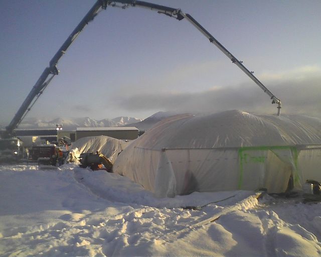

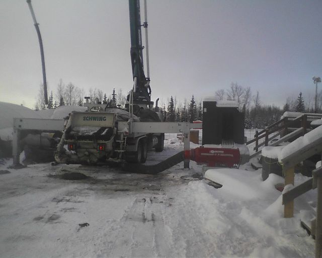

1 full hour of pre.heating... 2 insulation blankets draped over the deck w/2 big heaters, 1 to the pump kit & 1 to the assend with the tip hose over the exhaust |

20 degrees C.. Pump On! |

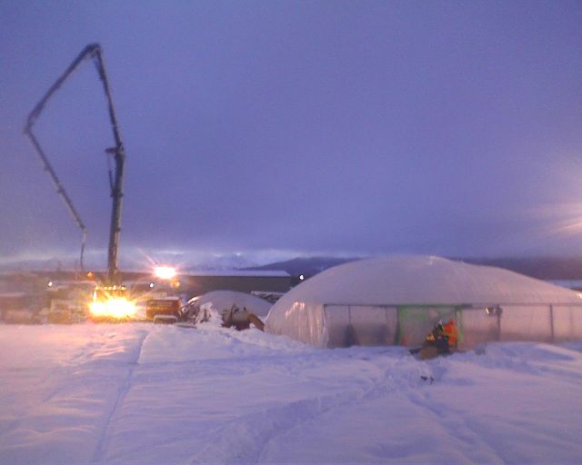

Then hurry up & blow out before the shite freezes up! The 10+ minutes it takes to boom back to the mixer is a bit nerve racking. Hyd. oil in the boom cylinders so thick you could cut it with a knife. |

Keeping water fluid and flowing enough to wash up the pump is the funnest part of all of it! |

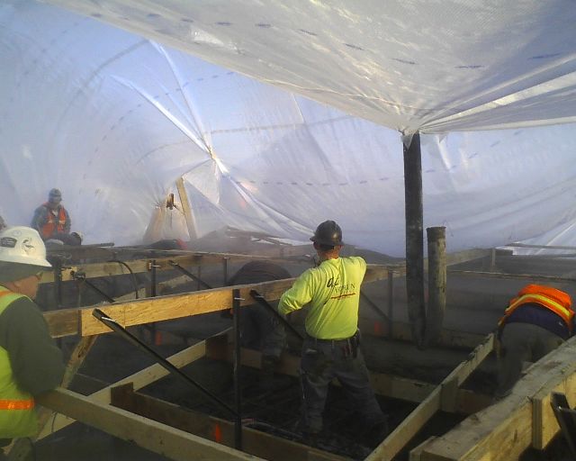

Wow TooTall, very cool. I hope your making bank. Thanks so much for the pictures. |
PrariePumper | 11-09-2011 | reply profile send pm notify |
Nice pics, where are these taken? |

What was the outside temp? |

lol you need to insulate your boom pipe makes world of difference in the cold temps works great for us in sask. for the winter we are also looking at insultating the hyd. lines to help keep from the fluid turning to sludge |
Z-Boom_Parks | 11-09-2011 | reply profile send pm notify |
We have our booms here in Sask wrapped too but we use a little thinner Hyd oil in a few of the pumps and that seems to make a difference, not as thick in lower temps. Anything below -25C and we wrap the pump kit and heat it. |

When we bought one of our pumps back in the early 90's the hydraulic tank was full of a red fluid called automatic transmission fluid (atf). The cold temperatures and lower pouring point (of atf) may have had something to do with working in a colder climate. |

Realy cool with -25 I use to just cover the whole truck with an awning. Tugg it propperly in and the excaus gasses will keep the temp above 0. By the way.. I was told that you shouldn't operate a pump under about -15 because the caracteristics of the metal in the boom changes and makes the boom weaker.. |

Insulating the hydraulic lines will do very little. The volume of cold fluid sitting in the cylinders is what makes the boom so sluggish. Open up the wallet and change the hydraulic oil in the boom's system. If the oil isn't houred out, it's a good opportunity to refresh it with a filter cart and remove any moisture via vacuum dehydration or with filter elements. It can be used again when the wheather warms....same goes for the lighter 'winter' oil. |

They're current pics from a cpl weeks ago. The project is on Elemendorf AFB in Anchorage AK. Fun stuff!! It's barely been above 0(zero) the past few weeks so I've been a line draggon pumpin everything with a Schwing 1000 lately. |
