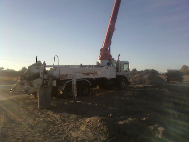

thommyman | 11-26-2010 | reply profile send pm notify |
this is the size of bucket i use. suck half way down then raise hose out so it sucks air then suck up the rest of the water. works every time. if in doubt then suck a sponge. |
