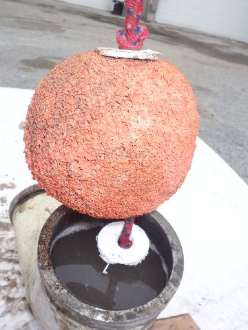

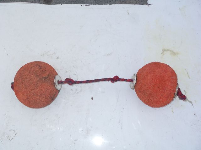

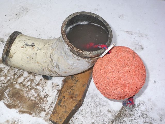

Was tipped-off to this setup from a Con Forms rep. at the WOC show. We had issues with buildup in our deck pipes using square sponges, since switching to this setup all pipes are now "squeaky clean". The rope linking the sponges prevents them from rolling through the pipes and also keeps a pocket of water trapped in between the two, effectively rinsing the entire diameter of the pipe.
It have noticed a huge improvement in ease of priming the boom since switching over to this setup. |

the two sponges are a little more money in the short term, but when you run the numbers.... The square sponges are $5 each and last a month at best (we had guys that were going through 2 a day)... The 5 inch. round balls are $15 each and last at least a year as they do not hold slurry and harden over time like the square sponges do, I think because they use a rubberized foam material, which also means you don't have to spend nearly as much time wringing them out the end of your washout...
Anyhow, even at a conservative rate of 1 square sponge per month, 7 months down the road you'll be ahead of the game... not to mention those nice clean pipes and buttery smooth primes..

I purchased them from your main competitors (the blue and white guys), they really do have a great parts department... The ones I bought are actually a putzmeister part # I personally have had much better success with the soft sponges. I pick through the bin and find the softest ones I can, it's like shopping the produce section at safeway! I know that Alliance also carries them as well, but they only have the hard one and were more expensive (something like 20-25 dollars) |
