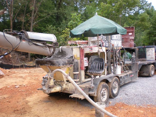

Almost all of those pumps are 4 cylinder engines, dipstick if you don't have a line pump you are missing out on the little jobs that pay really good, listen I'm almost 63 years old I feel very comforable with a line pump but a boom pump just scares the hell out of me.

Yes Biged.. I see the picture. I have so many jobs like floors inside where I stand with a big pump and only have like 10 meters boom inside.. And then 2,5'' hoses all the way.. Slow pooring almost all the time. max 30m3 per hour.Why not get a line pump and put down 10m extra line.. It must be a hell of a lot cheaper to take a job like that with a line pump than a 38m boom pump.. Here where I am now its the operator anyway that is pulling and connecting the line so there is no difference for the customer anyway...
These customers are all about the price.. So if I give them the first 15/20m system for free they don't have to think long i think..
biged 09-27-2011
Dipstick I see what you are saying, I have a second man figured into my rate cause these finishers here are the same as yours we set up all or hose plus even run the end hose and on walls we place it also just ask them to help move the hose, do you do block fill I make a very good wall hook thats easy to turn, madder of I am thinking about trying to Patent my wall hook  it will be called easy turn.
