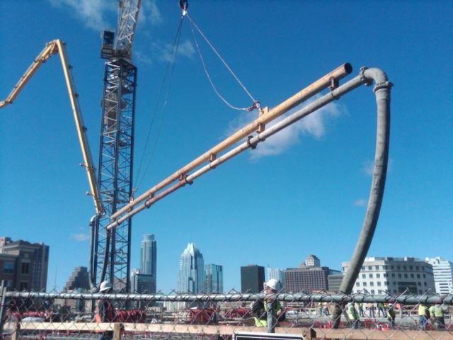

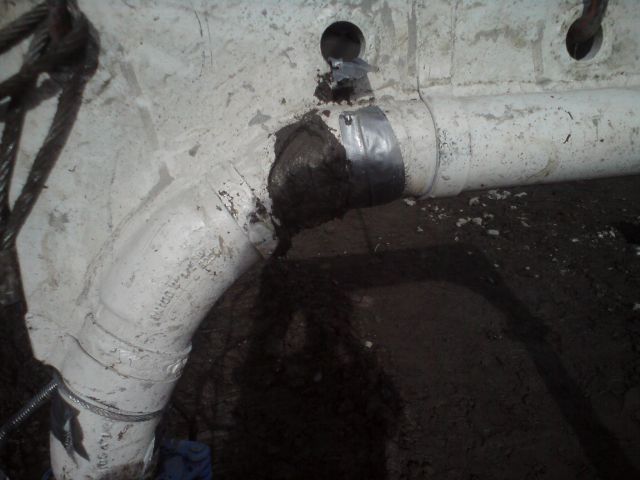

Whats a safety strap? |
Shoalwater | 01-14-2013 | reply profile send pm notify |
The one in Austin is missing 4 safety straps. Not much thought towards being safe. |
pumper plucker | 01-14-2013 | reply profile send pm notify |
spreader pipe dangerous period !!!!! |
gaby_steel | 01-15-2013 | reply profile send pm notify |
It is dangerus. i was driving RMtruck that day when a friend went on that job, i was unloading when that happend is not funny. extream heat from wealding ruined the metal quality. |
pm36m | 01-15-2013 | reply profile send pm notify |
wheres osha thats a big no no wouldnt evan hook up to it and looks like the one pic has a double 90 on it |

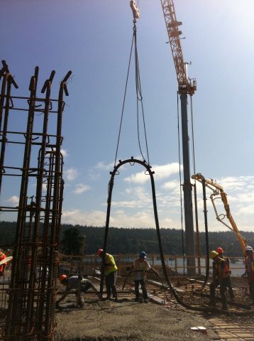

Todd | 01-15-2013 | reply profile send pm notify |
Here is something good to look at, http://www.concretepumpers.com/sites/www.concretepumpers.com/files/attachments/nocraneuse.pdf
yoda | 01-15-2013 | reply profile send pm notify |
Dipstick | 01-17-2013 | reply profile send pm notify |
No.. guess its better with a crane and a tub. Than the concretepump can stay in the garage and the driver can polish his truck.. |
No.. just kidding. But its funny that I spoke to a guy from Potain.. A BIG crane manf.. He said it was noooo problem to do it. I asked if he was sure and told him what is beeing said on this site but he still insisted we could use his crane for this purpose... |
