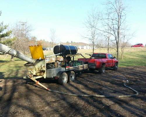

something like this? |

I like that setup! |

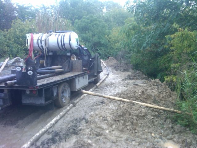

have a small gas portable dewalt AC you can carry an old alum water tank from a wrecked mixer and under bed boxes for clamps n reducers etc |
| thinksnow | 01-30-2013 | reply profile send pm notify |
the water tank has a heat exchanger in it that runs off of the engine i also wrap the tank with fan fold |

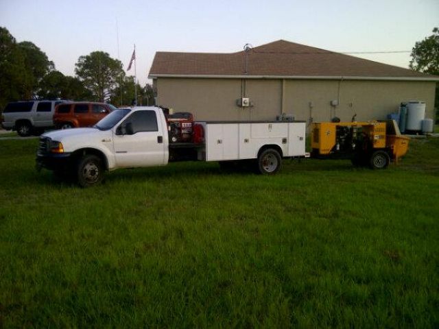

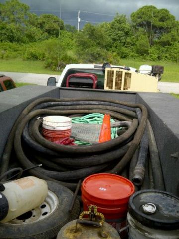

Call me crazy, young, or dumb, but I love my F550 Service Body set up I have going. It's a little work to get the hoses in the back of the truck, but I carry 375' of 2" line in the bed along with 300' of 3/4" water hose, 10 gals of hydro oil, 10 gals of diesel, spare for the truck and pump, diesel sprayer, cooler, and from time to time a pressure washer. I also have all my clamps for the 2" and 3" system, all reducers elbows and system related stuff. Carry couple cases of greese, many washout balls, slick willy packs, a vibrator, I also carry a full set of tools, extra oil's hammers, saws, pump parts, truck parts, filters, and a lot of random crap. Also have a 8500 watt gen set and 30 gal gas powered IR compressor on there. And when I am not pumping, its towing a GN with all kinds of crap.
I keep stuff off my pump because of the stupid axle that it has. Way to easy to overload it. Plus I want everybody to see envy how clean it is. LMFAO I can tell you how frustrating it is to show up to a job and not have a reducer....Best to have one truck for that. Plus the beating it takes, don't want to wear out your daily driver. |
| Goose2448 | 01-30-2013 | reply profile send pm notify |
This is my pump truck |

And the bed, on a good day |

That looks clean most wouldnt know what its for no concrete splashed on it Nice Do you have a water tank? |

Ya that looks like what I was thinkin but lookin at it and others Im startin to change my ming Maybe dedicate a flat deck truck to the trailer might be my style Thanks for the pics Savin me time and money for certain |

No water tank for me. That's why I have 300' of water hose. Most of our jobs have water on site, or we pull from a neighbor or something. I have had to use the truck's water, but we know in adavance if we need too. I know the flat decks are easier, but having used our flatbed chevy that tows GN's as my backup pump truck, I would not want a flat bed for a pump truck. It's easier to put the hoses up there, but not much. And it all has to be strapped down and its just a pain for me. Just throw all the crap in the back and off I go. |

Water tank with a pressure washer makes quick work of hopper clean up.Mine has a 2" quick dump into the hopper to fill it up with clean water to pump thru hose with sponge.I hate begging water from anyone. |

i did that service body when i started went to a flat bed with racks and only use 1 strap! no climbing and my AC i can carry to clean the lines out if needed. ive done 3 jobs in 1 day and never had to fill up water.wtf u need a generator for a refridge in the tool box. that pic of the trl is nice also any trk any time |

I guess the difference is that I am friends with all the concrete truck drivers, and everyone else's boss basically. I get what I want or need. And I know all of my jobs, because I am there before I pump when I deliever the equiptment and materials to the job. No place for a water tank on that truck. Still have to have clearance to swing the Goose Neck around. And besides, I am already close to 40K pounds with a loaded trailer on that truck, a water tank would just be more weight I don't need. But I do like the direct dump into the hopper. There is nothing more frustrating than having a slow water connection. |

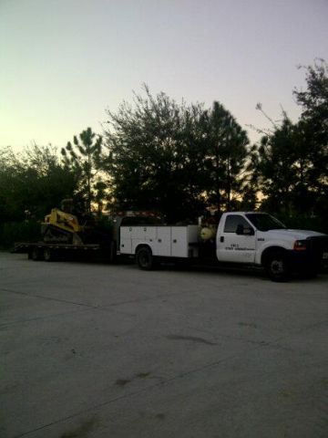

I have the genset to power lights, saws, drills,viborator, what ever may be needed on the job. Remember this truck is more than just a pump truck. Its a service truck, pump truck, Trailer puller, and whateverneeds to be done. Nothing beats being able to roll up on a job and go, Yeah I got that, got that too. What else you need?
We were setting up a pipe stack on a job, and the power went out. Needed it to run the drill to install the Redheads for the pipe clamps. So we dropped a cord down to the truck and fired up the genny. Kept putting up the pipe stack. Or night pours, run a light to the hopper so they can see what's in it. |
| Goose2448 | 01-31-2013 | reply profile send pm notify |
I also do this with my pump truck |

crete if my pump wont suck the ball back (over 150ft) ill cap it and put air to it. ill follow the ball and stop it 20-30 ft from pump. release the air then suck it to the reducer then break down all pipe then take the pump to wash out i dont rinse any hose the ball went through just wash clamps. my air comp is a dewalt gas honda 5hp u can carry it with 1 hand on a good day or have 200ft of 1/4 flexzilla hose on a reel (leave comp on trk) that sucker charges the tank and cleans lines its the same as what roofers use. we are in the process of geetting a new trk F450 4x4 6.7 diesel so in april ill put her on here. Goose these trks do nothing but pump |
