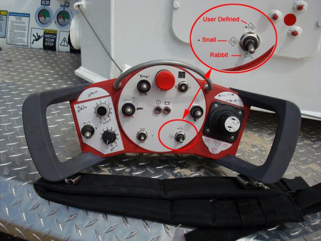

- Set boom speed switch to “rabbit.”

Now, before you stow the outriggers, let’s set slew right in the “snail” position:
- Turn the radio on and reset the e-stop.
- Switch the boom speed control to “snail.”
- Move the stick to the right until the WBV valve engages. The “creep” speed will be the same as it was in “rabbit.” DO NOT attempt to Tele-Teach this minimum. That will change the rabbit setting as well. Center the stick.

- Move the boom speed switch up to the user-defined position and hold it there. It’s spring-loaded.
- Move the joystick right until the desired maximum speed is reached and hold the stick at that position.
- Release the boom speed switch
- Center the joystick. Now, even if you move the joystick all the way right, the boom will only slew to the maximum you set with user-defined.
