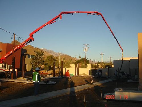

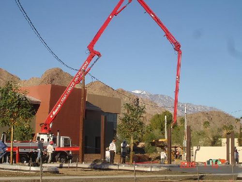

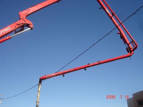

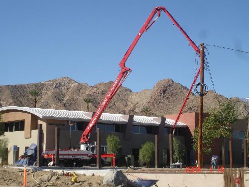

after arguing w/ the job super for about 10 min. and providing him with a generaror for his other workers to have power i KILLED the power lines personally, so NO worries guys

Vasa | 01-17-2009 | reply profile send pm notify |
Hi Toper ! Could you locked the powerswitch ? So nobody else switch it on again when you where pumping ? No bashing just wonder , it is not so fun if the power come back when the boom is that close to the powerline . |
toper | 01-17-2009 | reply profile send pm notify |
no the power box had no way to lock it but was parked about 20' from it and kept an eye on it , and there was only about 5 poeple other than us on site, mostly landscapers ,but i aprreciate the heads up |
b-alto | 01-18-2009 | reply profile send pm notify |
If those are after the transformer rubber coated. I would think it is safe. You can touch the rubber three wire. I think even if it shorted its only 240 volts? What do you guy's think about booming over this type wire? |
Lazy | 01-19-2009 | reply profile send pm notify |
The power lines are "Bad" . But whot about safety straps between hose and reducer |
pudg | 01-19-2009 | reply profile send pm notify |
b alto, NEVER NEVER go over a live line 240 volts enuff to kill make sure its off no matter what the life u save may be your own. |
cifa36z | 01-19-2009 | reply profile send pm notify |
B-Alto
seriosly are u in the u.s.a. ask osha what they think they will tell you some horror stories about wires nothing to joke about |
b-alto | 01-19-2009 | reply profile send pm notify |
I reshingled a roof last week in so. FL, an apartment building with a mansard roof. I rented a man lift to ride on and do the shingling. There was the service right in the way. I touched it, moved it and reshingled around it. Rubber coated two hots and a ground twisted together. I wouldn't even consider getting near a bald high voltage wire, but this was 240 coated wire. As far as pumping around them? I own a line pump for those jobs. |
