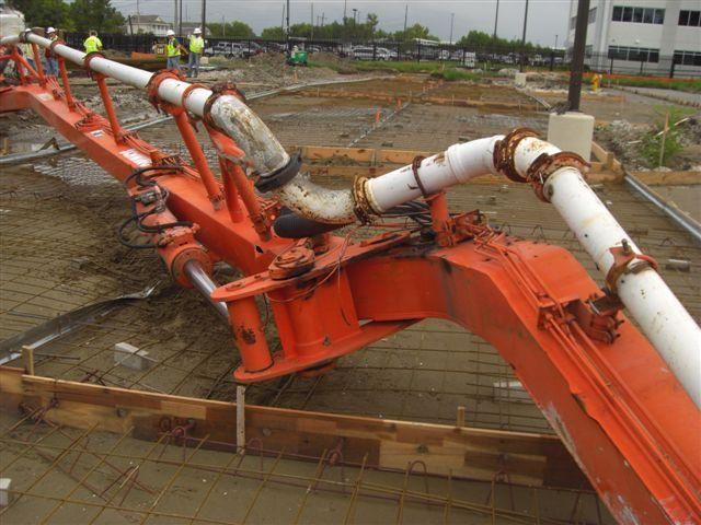

The unit was operating at a job site on 7/25/11 when the ground gave way causing the unit to roll over onto one side.

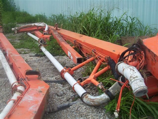

The unit was operating at a job site on 7/25/11 when the ground gave way causing the unit to roll over onto one side. As a result, the unit sustained physical damage as shown in the photos. Damage includes but is not limited to the boom sections, boom cylinders and pump pipe.
Per the location:
The engine did not seize. The unit was uprighted and driven back to the current location on the 7/25/11.
The location believes that the engine is undamaged as it has been started within the last 4 weeks.
The location does not recommend that the unit be driven for a more than 10 miles. For longer travel, the location recommends that the unit be transported on a low boy trailer.
Please NOTE: some of the boom sections were cut as shown in the photos. All boom sections are included in this sale.

So sad, makes me feel bad just looking at the pictures.
thinksnow 04-23-2012

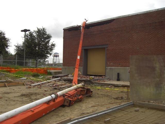

OUTRIGGERS?  I DONT SEE THEM
ALMIMA 04-23-2012
Soft ground, maybe they are 10 ft fully outrigged straight down in the clay.
any pump 2 04-23-2012
what aload of boll##ks the out riggers not even out , driver should be named and shamed for shit like that some 1 could of been killed
Many 04-23-2012
This is a good example of the aftermath,the end of the paper trail.Excluding what the operator did,or didn't do,or even the tow truck driver.I do believe an insurance claim was made,affecting everyone,a final chapter if you will.

 I not so sure all these pumps tipped over. I think they are pictures of different types of accidents. Was your point outriggers or just everyday stupidity. The one ORANGE one looks like it might have run into something.
Dont need one 04-23-2012
Actually pictures 8 and 9 look like another big boom with a lot of rear boom overhang might have backed into those other pumps.

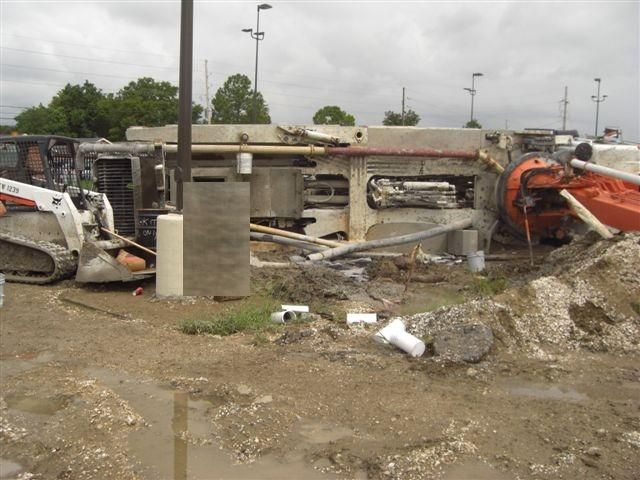

The first was a roll over I believe. Had a rearend problem and drug it off in the ditch. He is in a wheelchair now. No operator error if that's the truck.

 Again I looked at the first picture. If it was in transit it would have been folded up. I only see 1 section basicly standing straight up with only 1 section showing. Something to think about.
Dont need one 04-24-2012
 Oh sorry were you talking about the 1st picture or the one I was refering to.
yard whore 04-25-2012
Ya the first BB Pump pic.
Beast 04-26-2012

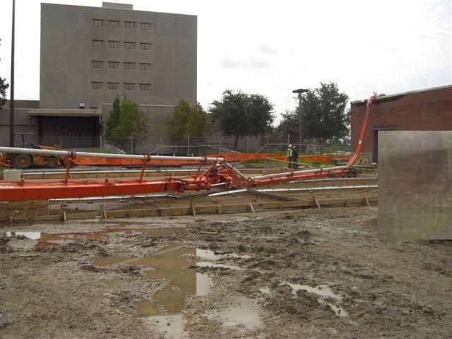

that rollover is down in south louisiana , sofffft ground water table 2-3 inches below ground level outriggers are completely in the ground offside was not out any per manufacturer specifications,but yes its still operator error, should have had mats may have helped.
FunnyBoom 04-27-2012
Im no detective but to me this looks like another case of putting the outriggers in with the boom straight up in the air.... In the first picture the main was definitely straight up along with the rest of the boom. and manufacturer spec says the front must be all the way in or out not the rear and most guys would at least pull it out of the locks. had the boom been stretched out there is no way the pump would have went all the way on its side like that, the boom would have caught it first.
the boom is also spun around to the back of the pump like he had put the sponge in and stood the boom up. Maybe he poured something we dont see in the pic and was finishing up. Some of my competitors had a few incidents like that happen a few years ago.
Dont need one 04-27-2012
 The first picture is really odd. From the looks of the top of the outriggers it's a schwing 47 meter.
The Cat 04-28-2012
the boom looks like it was striaght up in the air  the way it's positioned and also the back bend is open too..... the legs would of kept it up if they  were out .. just  a thought... if he'd got the ball back my standing the boom up then someone came a long and messed is routine up ( pulled the legs in early ) there's an accident waiting to happen... we've all been there..
FunnyBoom 04-29-2012
I'd say that's exactly what happened Cat
