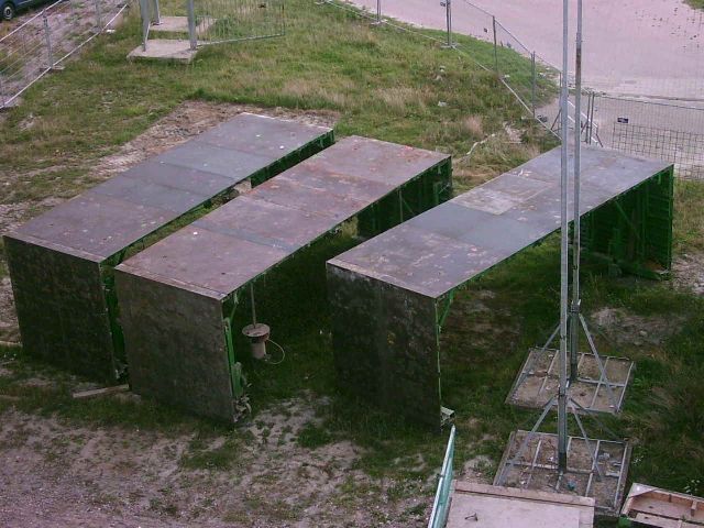

Seed; they build whit a so-called tunnel system. That means poring walls and deck in one poor. They don’t want to drag hose to the walls and then over the deck. The poor have to be done in two and a half our max otherwise they can’t remove the forms in the morning. The forms look like these. |

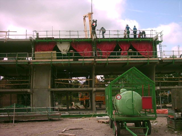

jeepers i wouldnt be standing in or on that last building |
Dipstick | 03-24-2011 | reply profile send pm notify |
haha.. I gamble that he moved the camera while taking the picture... |
