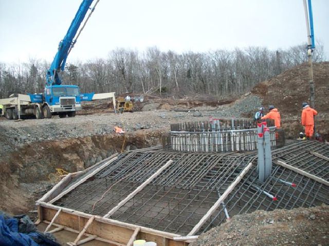

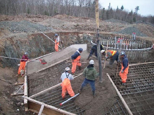

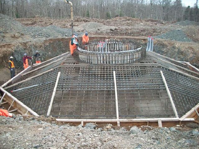

Todd | 05-17-2009 | comment profile send pm notify |
These were taken on top of mtn. Thorn
Todd | 05-17-2009 | reply profile send pm notify |
PourItOut | 05-17-2009 | reply profile send pm notify |
Gotta Love Them Thick Jobs, nice pics Pour It Out!!!! |
Pumper Tom | 05-17-2009 | reply profile send pm notify |
320 yards 4 1/2 hrs |
biged | 05-17-2009 | reply profile send pm notify |
And just think he done it with a pump ,don't take this wrong but a Tele Belt works good with stiff mixes, I own a pump but I will be the first one to say a belt blows a pump away on stiff concrete. |
bisley57 | 05-17-2009 | reply profile send pm notify |
Good pictures,but I question the engineering behind this foundation.If the foundation was not sloped in that manner,but flat,how much more concrete would it take?,plus you would have more "anchor" for this tower.Looks like alot of wasted work,bent re-bar,sloped concrete,angles.Guess we have to keep those REMF's busy. |
Many | 05-18-2009 | reply profile send pm notify |
Yeah,those belts have there place allright.Problem is nobody has really seen what they can do. I would be reall supprised if there wasn't a caisson in the center. |
Pumper Tom | 05-18-2009 | reply profile send pm notify |
crete was not that stiff about a 4 in slump but it was very sticky 40% fly ash |
pudg | 05-18-2009 | reply profile send pm notify |
why does it need more concrete,are you in the ready mix business,do you know if there is pilings or drill shafts under the foundation,sounds like alot of speculation off a few pics,jsut my opinion we pump what they want us to dont question engineering unless its on our equipment ? just my view.I think the op said 300 and somethin yds thats a pretty good anchor. |
Paint Master | 05-18-2009 | reply profile send pm notify |
nice pics |
aaronsrules | 05-19-2009 | reply profile send pm notify |
belts are best for wind work. more volume with tighter mixes no boom bounce no outrigger pads no need to wash out if you have to wait for concrete. my lil brother can move his belt from one base to the next in 8 min. fold up riggers up move set up and mud going in to the next base faster than the crew can pick up there tools and gets to the next one |
Pumper Tom | 05-20-2009 | reply profile send pm notify |
what if you need 100' reach belt is not much good |
40667 | 05-20-2009 | reply profile send pm notify |
huh The most popular belt is 105 feet and they go up to 130 feet. |
