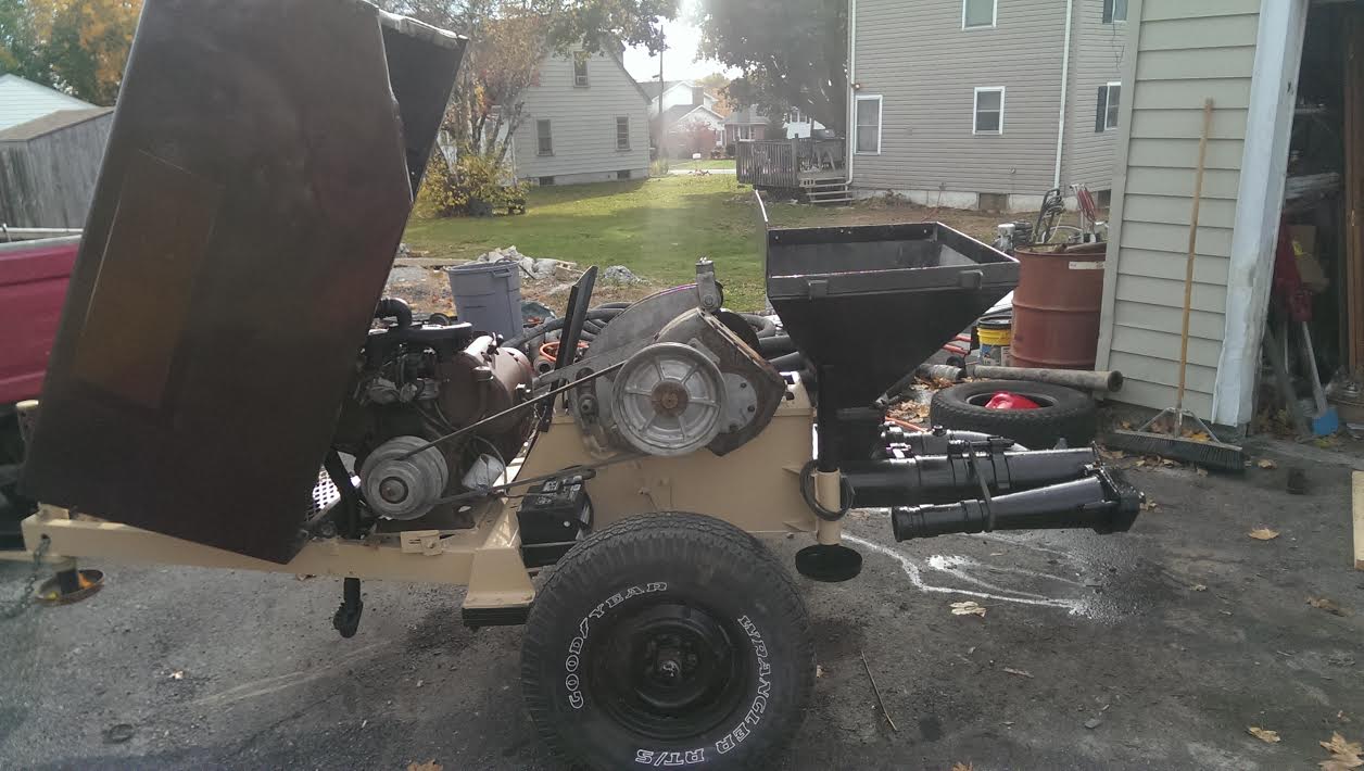

I have aquired an **OLD** Thomsen mechanical ball vlave pump, it is based on the Mayco C30. The unit is kind of backwards....than the Mayco, and has a gear box up top. The pump is in great conditoion and I am almost done rebuilding it but I do not know what model it is. I cannot find any literature. Most of the wear parts are the same as the Mayco but I cannot find the ball valve seats as they are not the same as the Mayco. Is there anyone familiar with this unit? Any info would be helpful. |

Most likely you have a Thomsen 260. Hopper was on the opposite side when compared to a Mayco C30. Is the hopper on a hinge for easy access? |
| jackpumping | 11-02-2015 | reply profile send pm notify |

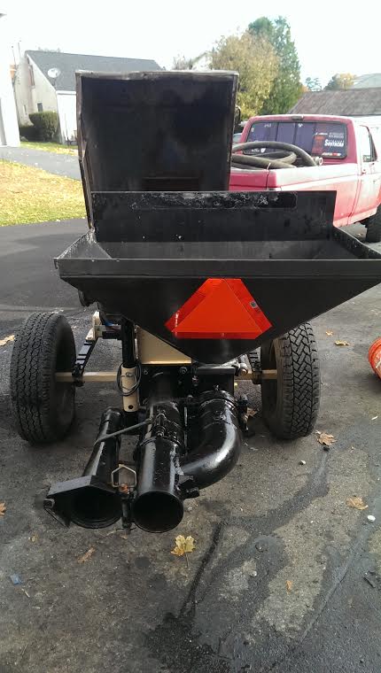

Yes it is hinged. I added pictures. Any chance anyone has a parts manual for this? |
| RJB | 11-02-2015 | reply profile send pm notify |
That is definitely a Thomsen 260. I know I have the original brochure and Ops Manual. Not sure if I still have a parts book. Call Dan DeFrange at PM West location. He can tell you what parts are still available. He has all the original drawings. Airplaco made a near identical knockoff of the 260 until recently. They may have parts that cross too. |
