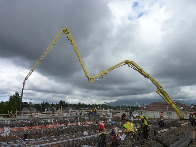

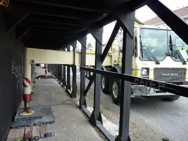

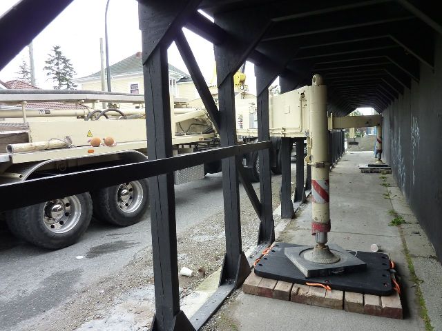

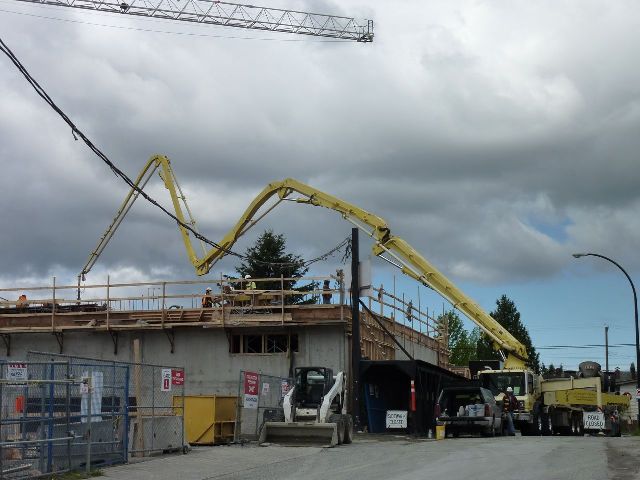

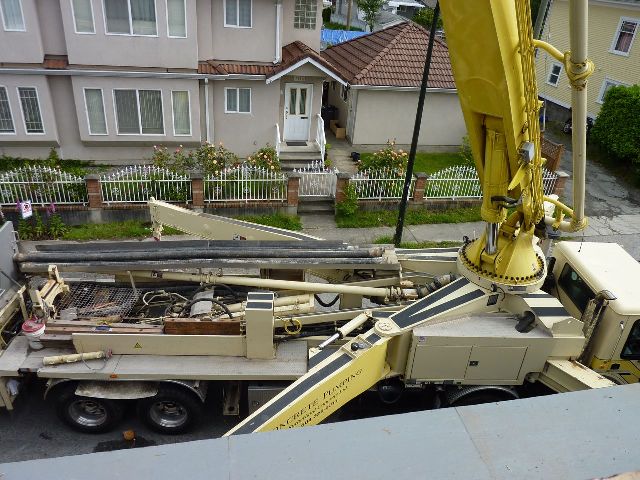

one of those days where I really appreciated having X-style outriggers!
PS. the boom is not over top of the low voltage lines despite how it looks in the first photo |

Tight set-up. Did you have a trusted person operate the outrigger so you could back it in there? What a pain - move, PTO in, adjust outrigger, PTO out, move, repeat. |
16 CELL | 06-04-2010 | reply profile send pm notify |
just me, myself, and I... and yes, it sucked.. think I was in and out of PTO four times by the time I got her in there.... one of those times when I had telescoping rear outriggers |

Nice 16cell,and good pics of some really professional donnage out rigger set ups. |
Dipstick | 06-04-2010 | reply profile send pm notify |
Wow... You use a lot of wood under your outriggers!! Is that concrete their standing on? I use that much on a 52m schwing when I stand in wet sand!!! |

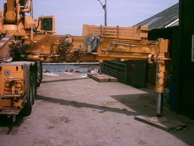

I like the 52 moost on crane mats |

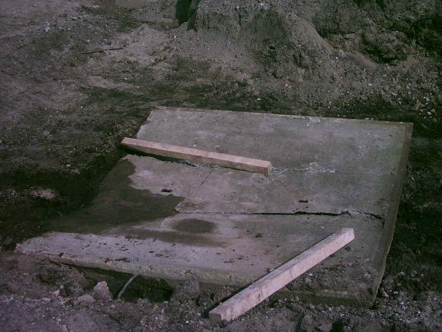

And i never trust concrete |

I am right with you on that one Superdoffer, concrete pads and city sidewalks especially can be deadly... no rebar in them, and often there is a void underneath where the ground has settled... If you read up on what the manufacturers recommend for dunnage (especially on big booms)... it can be a real eye opener. |

Yepp. Thats the 52 I'm talking about :-) Do they let you drive that thing now?? Even those crane pads can break I hearded. A 52m In holland working for vloertechniek used those on verry loose ground and it snapped. But A 42m doesn't need so much on a concrete floor I think. What will you do when you stand on sand than? Turn around and go home? But ofcourse everybody should do it his way. I wasn't there so I actually can't tell or know anything about the situation.. And maybe they didn't want the pavement to be dammaged. Maybe I am just lazy.. But I never had a pump collapse (YET ;-)) Here in norway the ground is so hard that I have forgotten how much trouble it was to set up a pump in Holland. Most of the time I only use the plastick plates for the look of it. Could actually just not use anything. Only rock :-) Greetz MR.B |

O yes... That looks like a stelcon plate. Those can never be trusted. They are indeed rubbish!! Some of them are made of rest concrete. |

Hey Dipstick that pic was taken in a little place called Ransdorp. I think you understand. B.T.W gretings from Bako |
Dipstick | 06-12-2010 | reply profile send pm notify |
It rings a bell yes. Is that one of those places where the ground is made of water with some sand in it? Looks like a job with BVV or De Jong? A strontkelder??? |
