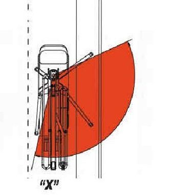

Check it out Wizard, Here is the safe/stable working radius of a properly "short rigged" pump. However it is an "X" frame and I know your current pump is different. You CAN recirculate and if the mixer you need to pump into is out of your "safe radius"?....... Move the mixer. If it is still against company policy to short rig then disregard all the above and keep putting all fours, all out! |

thewizard | 01-31-2009 | reply profile send pm notify |
wow it still seems like very limited work area over the front outrigger. A guy would almost need a spotter while shortrigged, good info it sure does add extra danger to an allready dangerous, and stressful job. Are there a significant amount of accidents that happen from shortriggin? My hats off to all that do, i would like to personally be on site of a setup like this to see first hand do's and dont's of the setup. good stuff PUMPON! |
