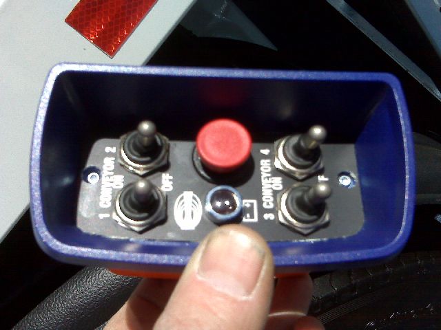

Travelteck 03-27-2011
while at the Con Expo I asked the HBC group about a small easy remote. The Patrol S Is quite compact and has 4 toggle switches and e-stop, looked like it would fit on a belt easy and fits in hand well.Take a look on the web site. I will get Pics later http://www.hbc-usa.com/en/Products/fwe-patrol-S-Forestry-applications.html

Travelteck 03-28-2011
Yes it can be adapted for Trailer pump I spoke to the HBC Reps at Con Expo and they said no problem. Call or e-mail Hector Sanchez 800 410 4562 x 104 hsanchez@hbc-usa.com Hector should recall talking with me. Tell him Alan Woods with Putzmeister asked him about this at the show
This is the remote they were suggesting.
Dipstick 03-28-2011
That looks realy perfect and small... (unless you have giant hands ofcourse ;-)  But it starts to look like my boss finds it to expensive... Any idea what this should cost? Here they are talking about 2000/3000 dollar...
