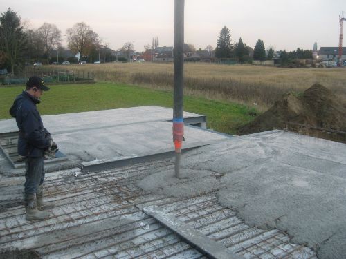

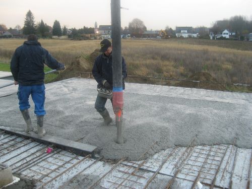

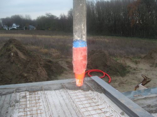

To prevent concrete from splashing out of the end hose if pumping at low speed I just use a traffic cone turned upside down. It's much safer like a small end hose or a double bend. I don't have block ups in a reducer cause I use it with a 125 mm end hose and if a bigger stone comes through, the traffic cone opens. What do you think about this?

Hahaha, cool. What did you use to attach it? Tape? And how long does a cone last?
Kris Leers 11-22-2008
I've got a very easy system to clip it on and of the end hose. It only takes a few seconds and it doesn't come of the end hose. I'll make some detail pictures on monday and send them over. The rubber flap over the end hose is just a cover for safety.
The cone lasts pretty long and if it's worn it's very cheap to replace.
A lot of customers laugh when they see it at first but once they've worked with it, they don't want to miss it anymore.

Always wanted a cheap redneck version of the Putz Pin Pour.
Those work great but wear out fast and I just can't find the right nozzle for the concrete first time.
Traffic cones are much cheaper if they work well.

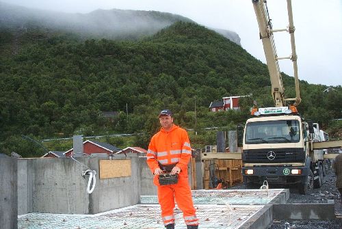

I've seen you're from Norway. Here's a picture from me pumping in Bodo. My friend's driver was on holiday so he asked me to help him with a job.

Nice.
How old is that pic?
I think I have driven that pump a few times, since it looks like
an old pump from another company.
This picture was taken in july 2007. This pump has run for 5 years in Belgium. Afterwards my friend bought it. I was in Norway to train him and we had a great time. I know he has sold this pump now but I don't know to whom

W.W.B.D. (what would Bob do) would you say this is a safe "trick"  i personally dont see why it would not be safe, but another opinion would be nice!
wesdogg 11-22-2008
ya it would be safe, if it has a reflective tape 4 those night pours. well you know your tip is rated 4 one discharge hose not a hose & a cone lol
TooTall 11-23-2008
(4) 16 p nails driven into the end of the hose at a downward angle towards the discharge end does the same thing. This looks like a hill-billy rough neck hose no doubt constructed with hill-billy chrome(ductape!) You could also use this for Decorative concrete placement by cutting a star shape in the end of the cone. Like decorating a big concrete CAKE! You would'nt happen to be a "Baker" would you Kris??? .......(<*>,<*>).......pump-off.
