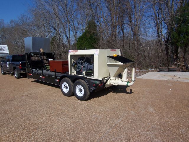

I know we tried this before but the thread kind of got hijacked.I am building a small trailer pump this winter and am looking for some set-up pictures. Like pipe racks,water tank,toolboxes maybe air tank? Thanks Terry
biged 01-10-2012
Crete I can't wait to see your ceration.
crete 01-10-2012
Hey Ed Thanks for the pic. Please donot side track the thread though.You other guys post some pics.T
biged 01-11-2012
Look who taking about side tracking a thread.
crete 01-11-2012
Ya not gittin any bites for pics. Come you guys, maybe they are all truck mounts on ths site.
biged 01-12-2012
There are not a lot of rigs like this, do you still want a 3 inch wall hook I found a 3 inch weld on.
crete 01-12-2012
No guuna wait until spring,unless I take a road trip down your way when things slow down.Can't beilive no one has any pump units all self contained like yours. Just seems better having your own water,pressure washer and stuff. Also not having your hose tie up the back of your pick up. But what do I know. T
crete 01-12-2012
Stinking 3" hose is so heavy I need a forklift to get to top of a wall ha ha T

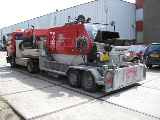

Here an example from the Netherlands.
Van der Spek, PM-representative, delivered a standard BSA 1005D.
Customer built this unit on a trailer chassis, together with Atlas Copco air compressor.
Advantage of this combination is that it can be driven without truck driving license due to Dutch laws.
ALMIMA 01-13-2012
I like you dutchmen - legaly drive a heavy trailer whithout an heavy truckdriverlicense?? I like it! In Sweden we soon (i think) got to have a license to shit in the toilett. I (every pumper in Sweden) needs to have a license to pump concrete!!! And i have it. Sweden in a nutshell....
