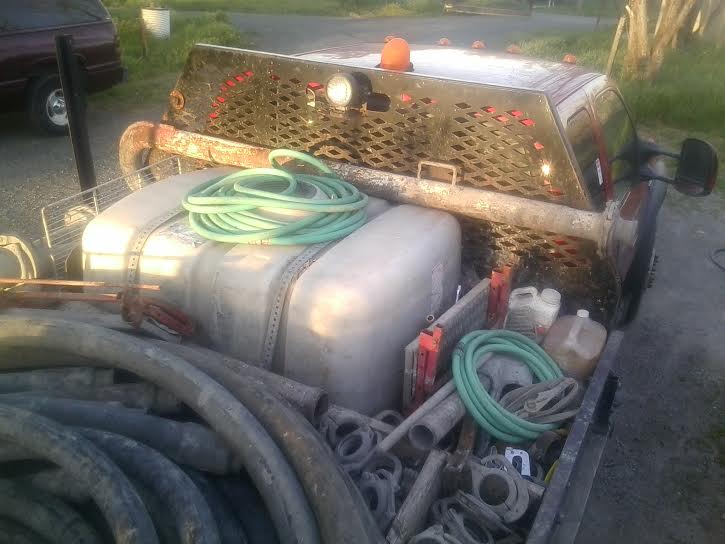

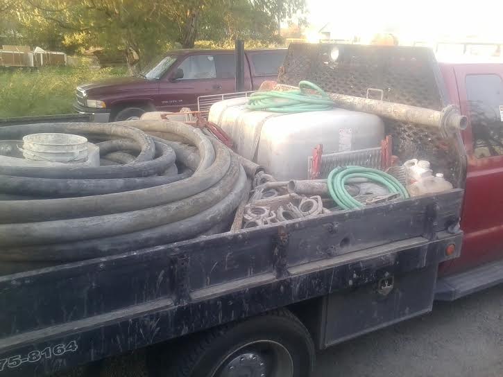

got a 50 gallon AG tank like $150- today with a 1.25 inch vacume hose for a gravity feed for tkb-30 I could go empty on my pick up to county job site and fill in advance with their three gallon a minute well, took awhile but I was ready to flush out hot mud just in time. |

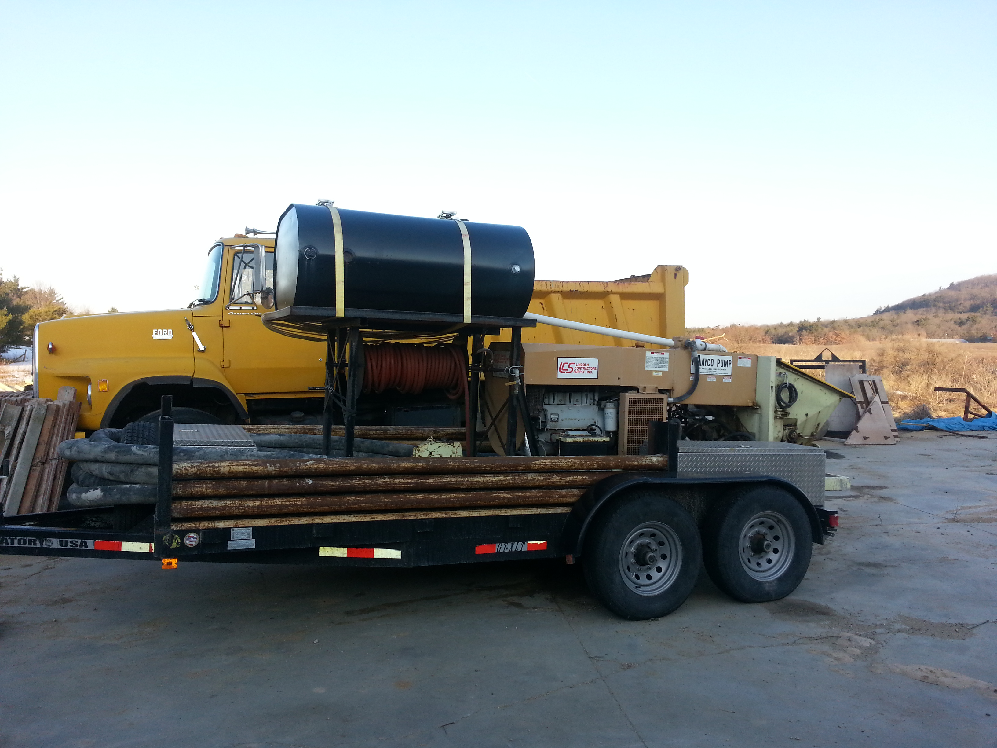

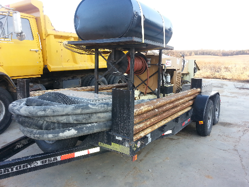

Here is a pic of my pump. 250 ga. water,150' garden hose,4200 psi pressure washer,160' of pipe,175' of rubber all 3". 2" quick dump into hopper for water washing system. Weighs just under 12k. |

Wow. 250 gallons is awesome.thinking 80-100 tank, 12 cfm compressor to help pull the sponge back on a 12 foot flat bed 1 ton diesel.run mostly 4" lines here and the job sites are always way too tight for a big set up like crete's.should get the job done til I can get a truck mount pump. |

wow big trailer means big truck equals truck mount. Here we have hills and off road, my one ton single rear wheel truck and tag pump does the job. My wash is push out the mud and keep the lines full of water as you break them down. My secret is 17 foot 2.5 inch hose. Those suppliers do not know how to divide fifty by three ha ha. So anyways we are ideally no more than thirty minutes from plant washing and in the cruel world that is not possible. I have washed the pump with a rubber feeder tub and three gallons of water, takes time and is hard on your hands but you can drive away happier but you will get that build up residue later. |

On washing hose twice I was self taught and just habit I guess. I will drop back to only once. The reason I have everthing on the trailer is so I don't have a extra truck dedicated just for pumping. I have a dually Dodge cummins that pulls it around perfect. |

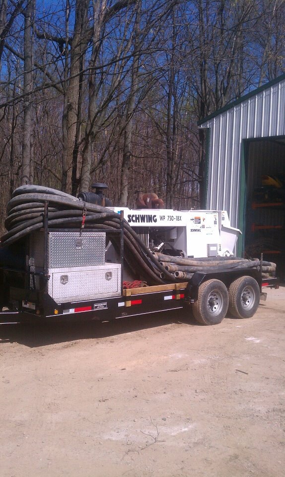

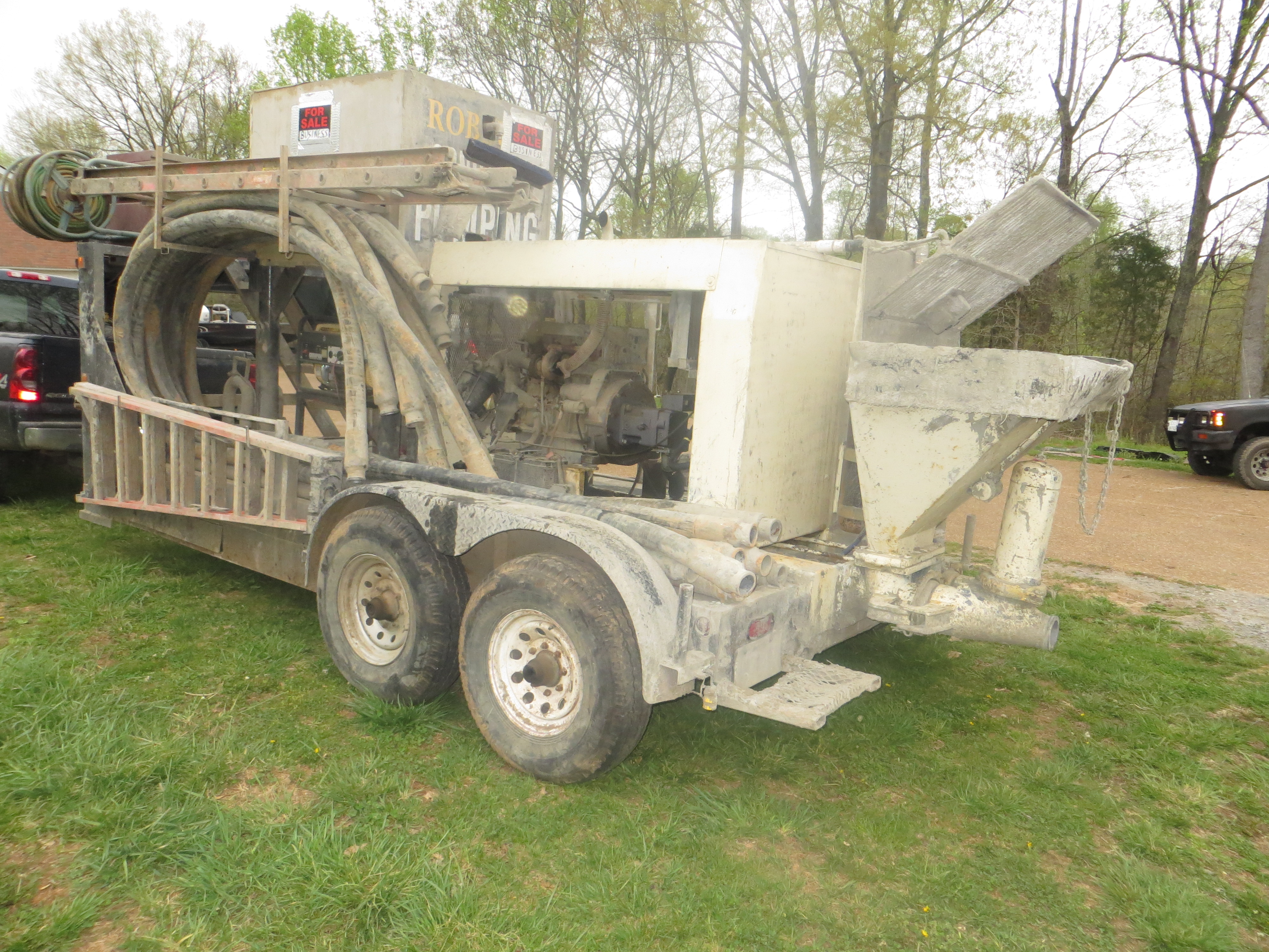

I built this contraption about four years ago and ingotta say having all that storage on the trailer is nice. Water tank and compressor are mounted on the trailer as well. Plenty of room for hoses, clamps, reducers and what not. |

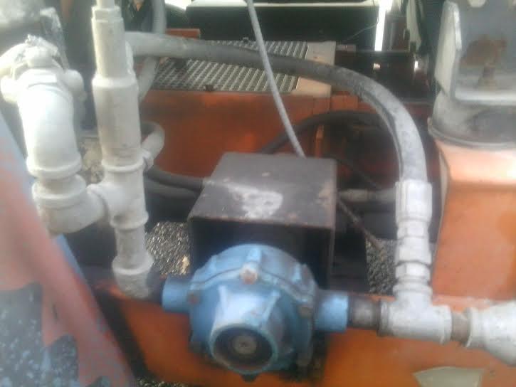

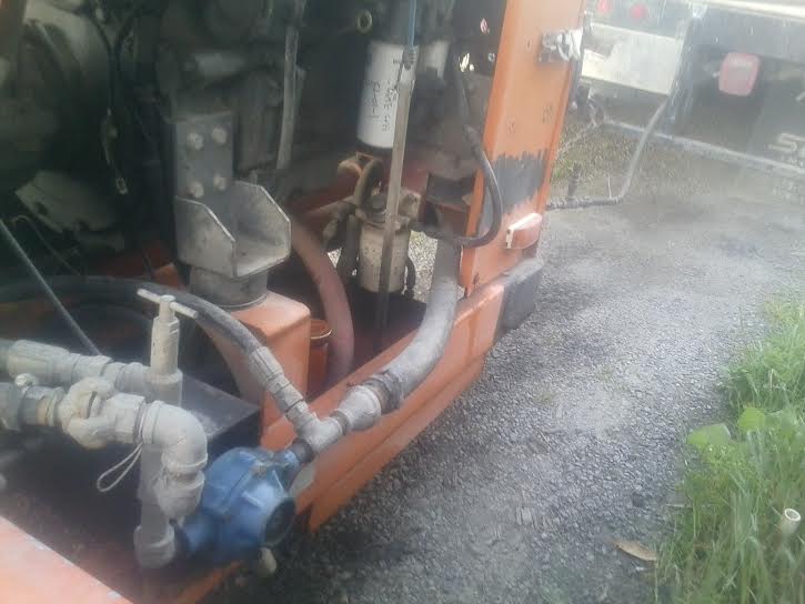

Here is a 10 foot bed with 300ft of 2 1/2" and 200 ft of 2" hose, the tank holds 150 Gallons and gravity feeds to the hydraulic powered water pump that robs its power from the re-mixer auger motor and produces 100 psi It can fill the hopper in 90 seconds. This set up is the best. I have used air. I have used gas powered pumps. nothing comes close to this, Same water pump set up as most boom pumps. |

Pumpatude thats a very nice set up! I could easily tap into the secondary hydro pump. The hypro pumps are readily available its just matching up the flow and pressure with the system that is difficult, what oil motor to buy? |
b-alto | 04-03-2015 | reply profile send pm notify |
Also RPM of the hydraulic motor is a factor. I would think it would be a low RPM system. |
Pumpatude | 04-03-2015 | reply profile send pm notify |
Putz sells an optional "water pump kit" for a line pump which includes SOME of the plumbing and the schematic. It is a little expensive but FYI the entire kit can be duplicated for less than half the cost at your local tractor supply store.

Goat only thing I see wrong your hopper is to high for RM shutes I cut the deck out and set my pump down low but other t5hat that its just find |
The GOAT | 04-19-2015 | reply profile send pm notify |
Biged, the back of the hopper is 50" from ground level, plus all the RM trucks around here are front discharge So hopper height isn't really an issue. Only time I ever had a problem with hopper height was when pouring with a dial mixer. The pump doesn't actually sit in the trailer deck, when I bought the trailer I cut out the entire center of it and welded in cross braces in where the pump axle would mount and also one where the tung would hook up to the truck. Wanted to keep access to the underside of the pump the same as how it would be if it where just on a regular axle. |

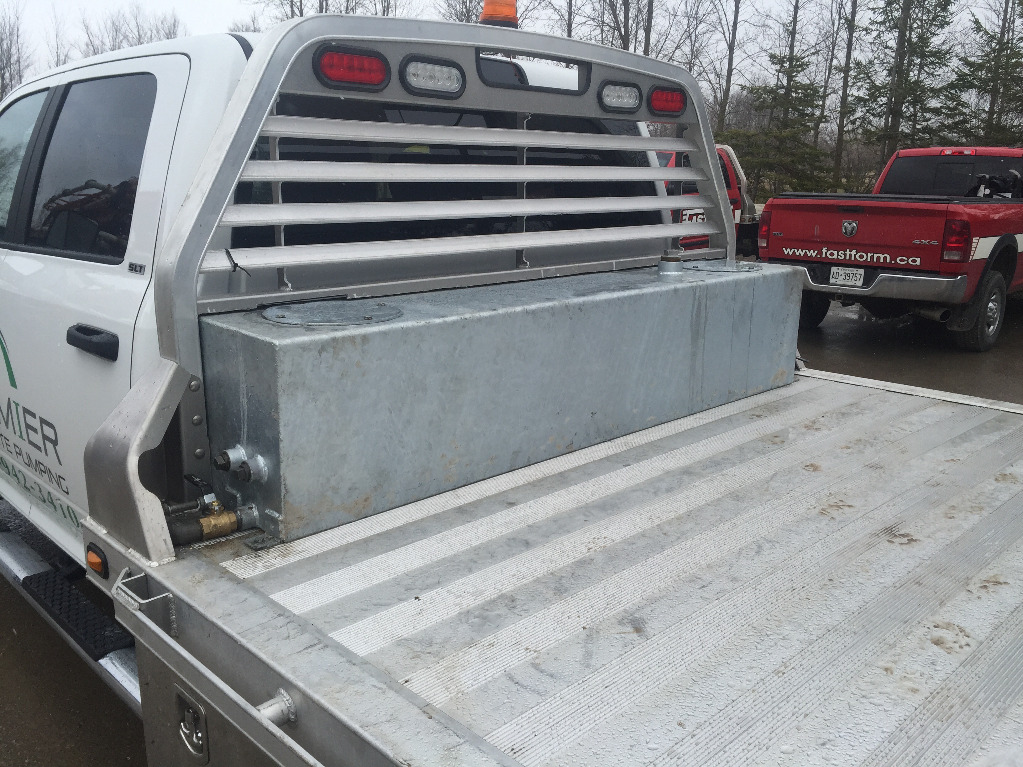

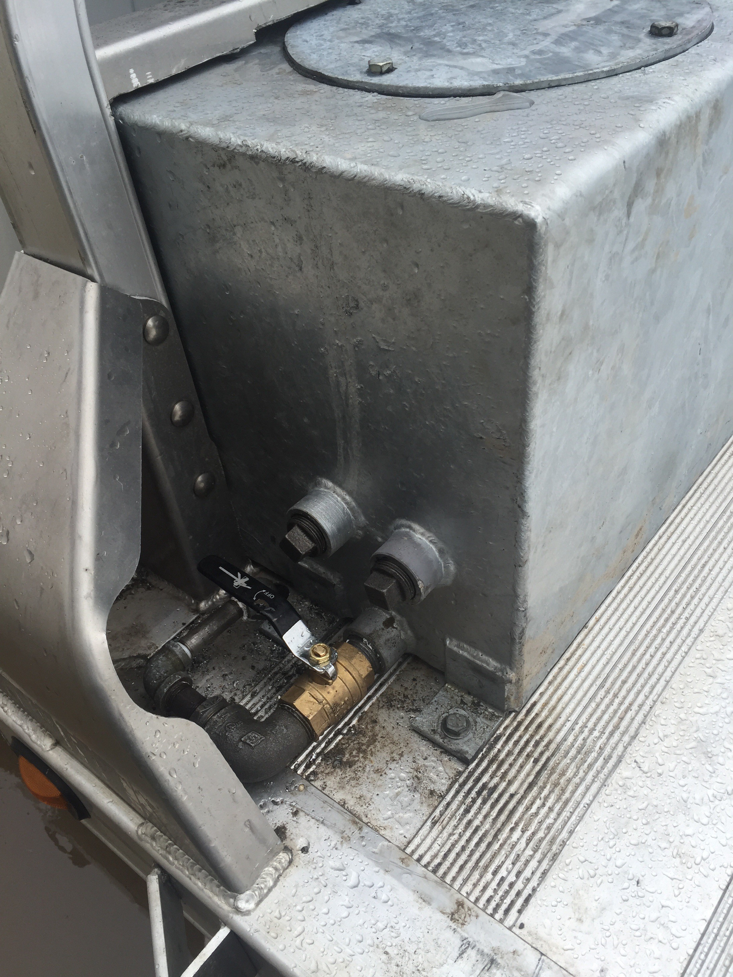

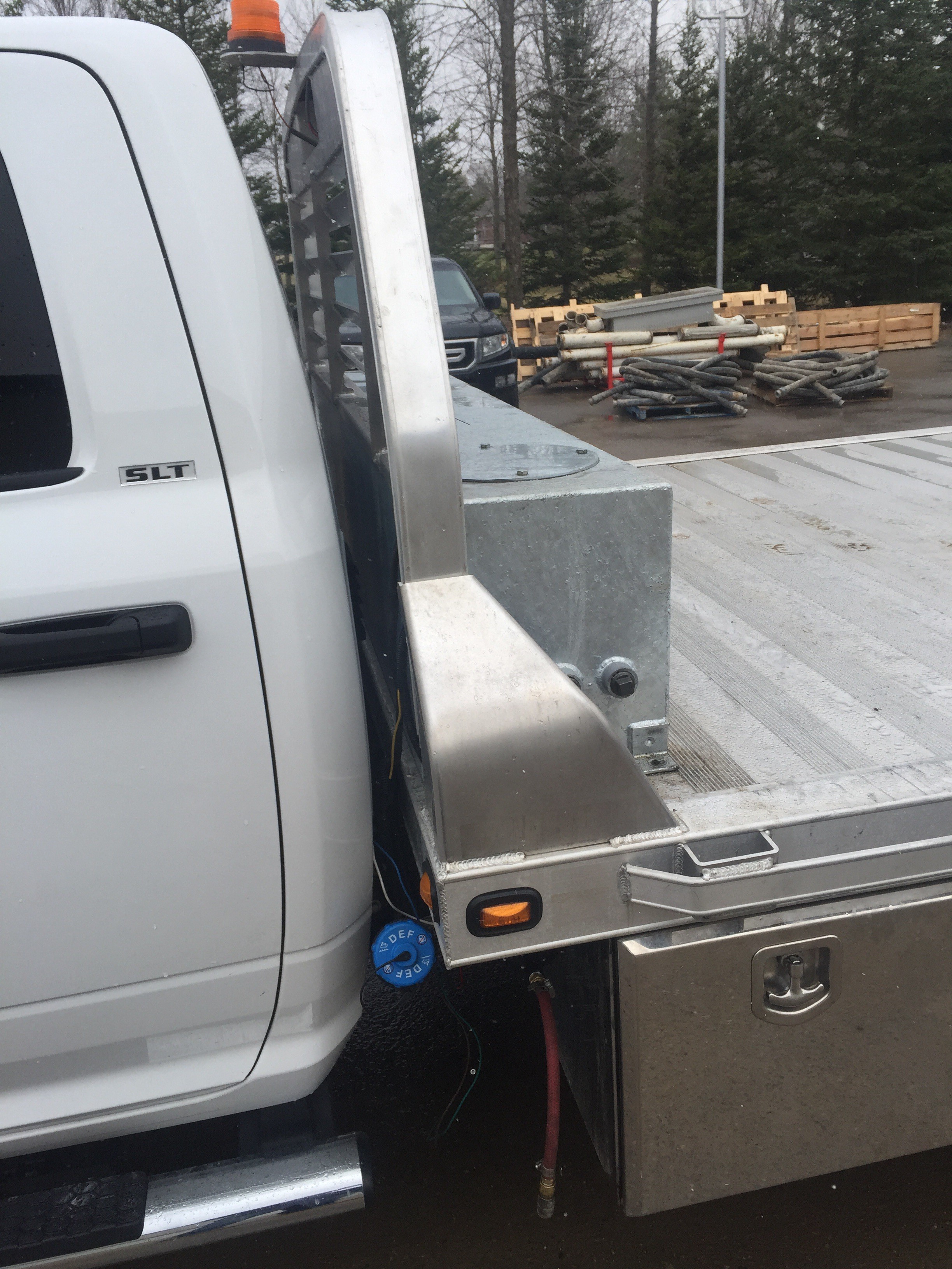

We had a 300l galvanized tank made up with a 12 volt, 17 amp, 70psi diaphragm pump(4gpm) that runs off the aux power circuit on cab/chassis models. the pump is self priming, and under 200 bucks. The tank is heated for winter use from the urea tank coolant lines. |
b-alto | 04-23-2015 | reply profile send pm notify |
Thats a nice truck and set up. I've thought of putting a bed like that on my rig but haven't pulled the trigger. Did a 12 volt diaphram pump have enough power to do the job? i wonder maybe two in series? I've got a line on an air. Those air pumps are very interesting, they can also be used for oil changes. Well, got two jobs to go pump..(boom) |

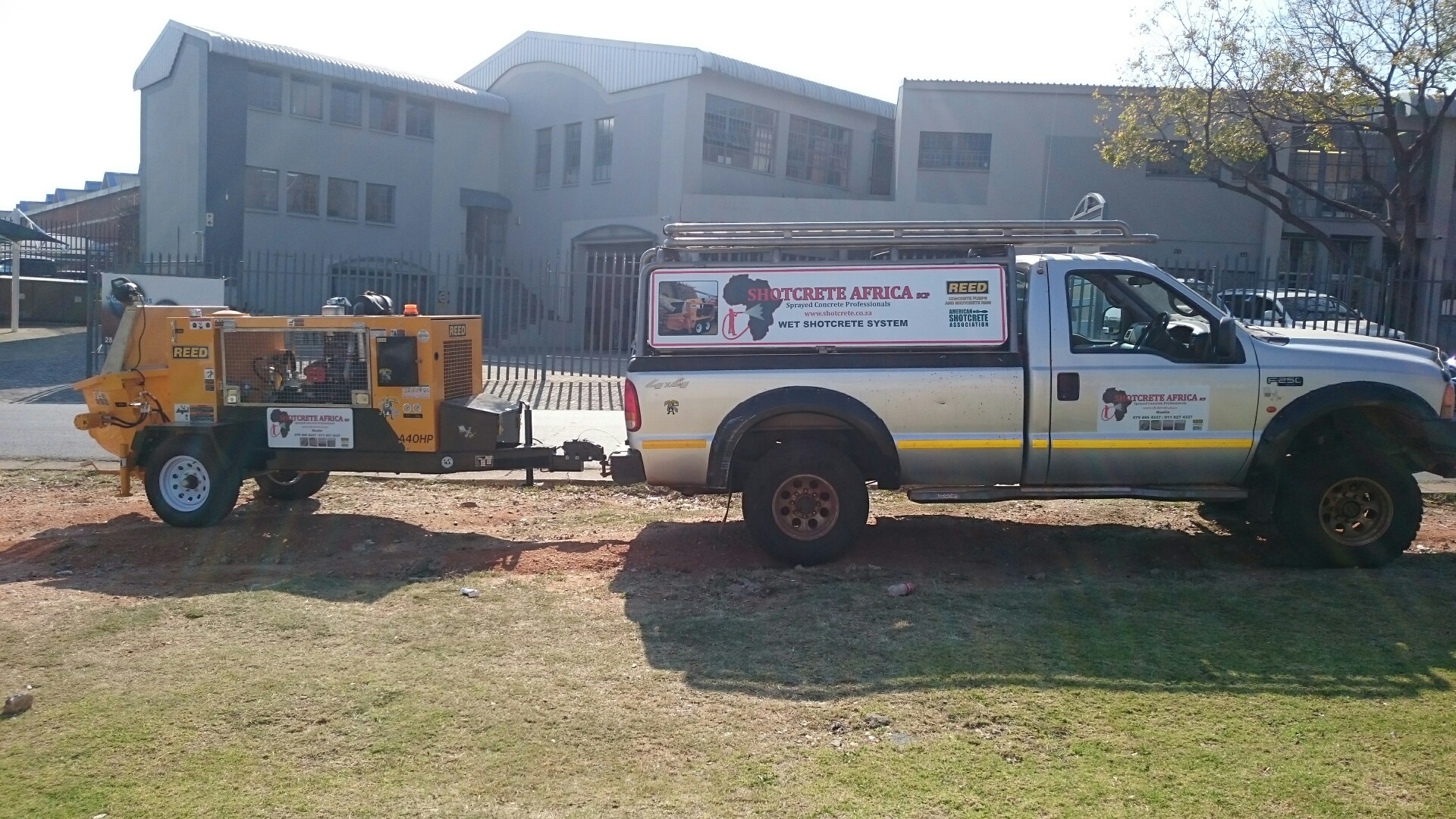

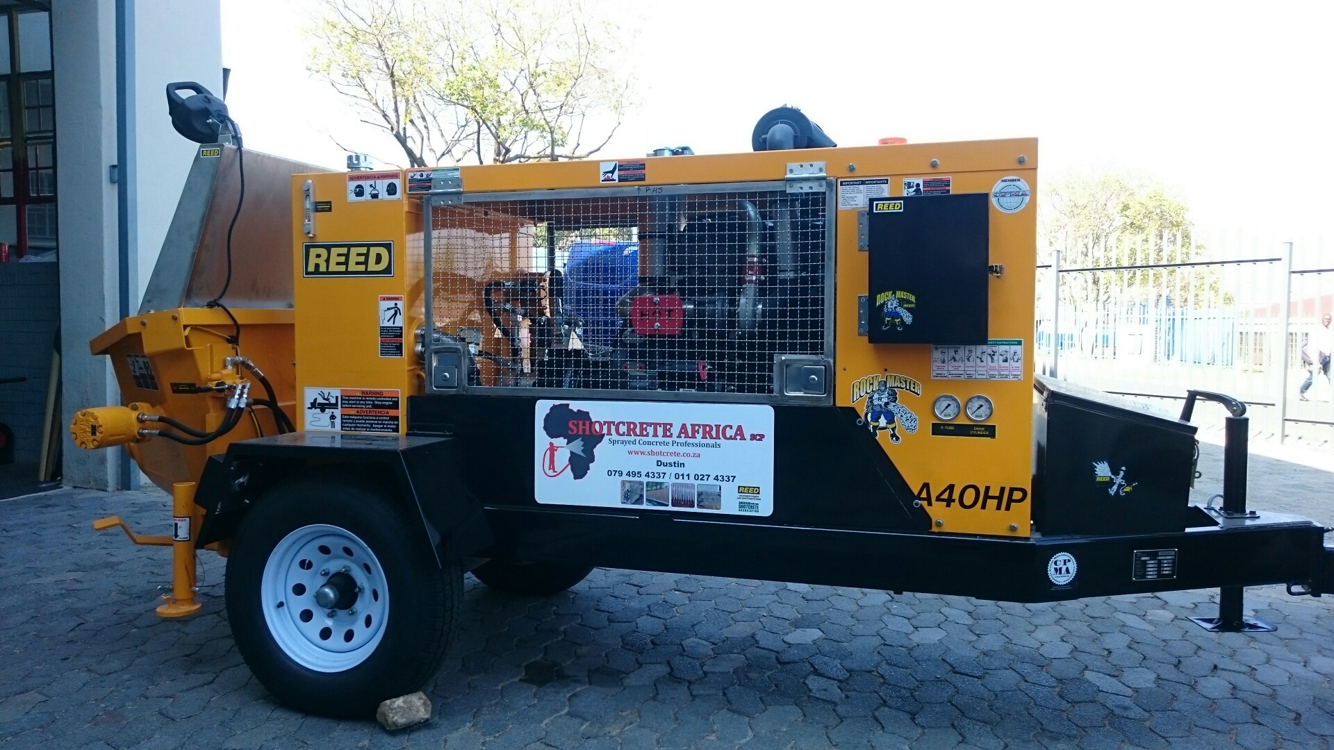

REED's Dealer in Johannesburg, South Africa, sent me this pic- he said the A40HP been "Africanized" (which apparently means adding a few guards to make sure no one steals the battery) Pretty cool that he's towing the pump with a F250... |

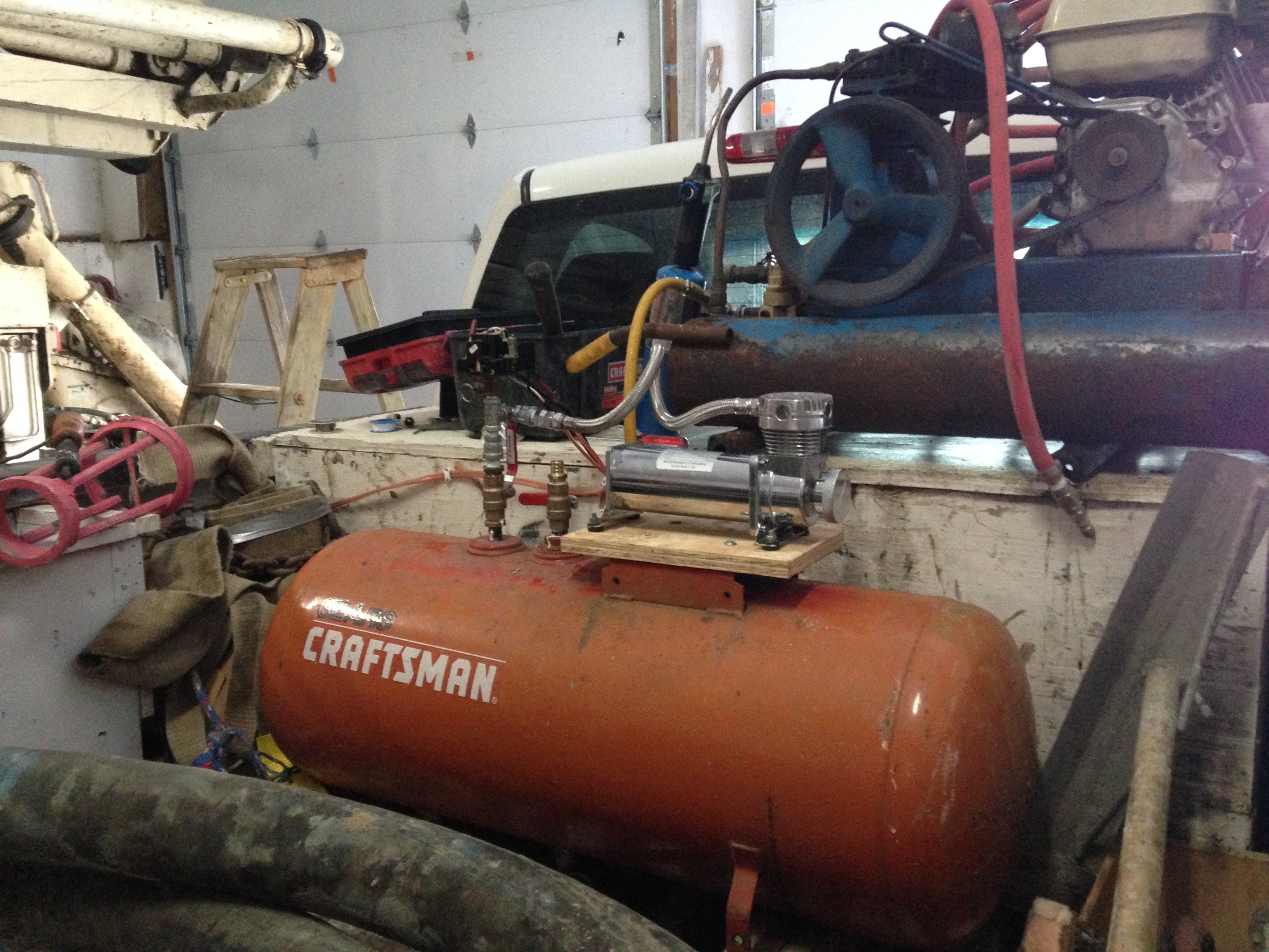

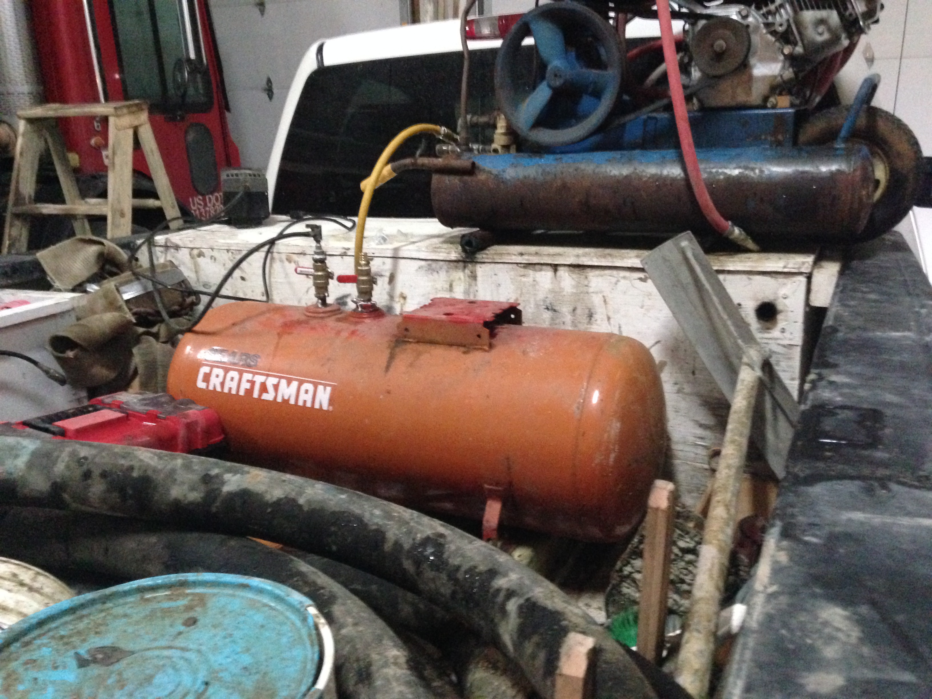

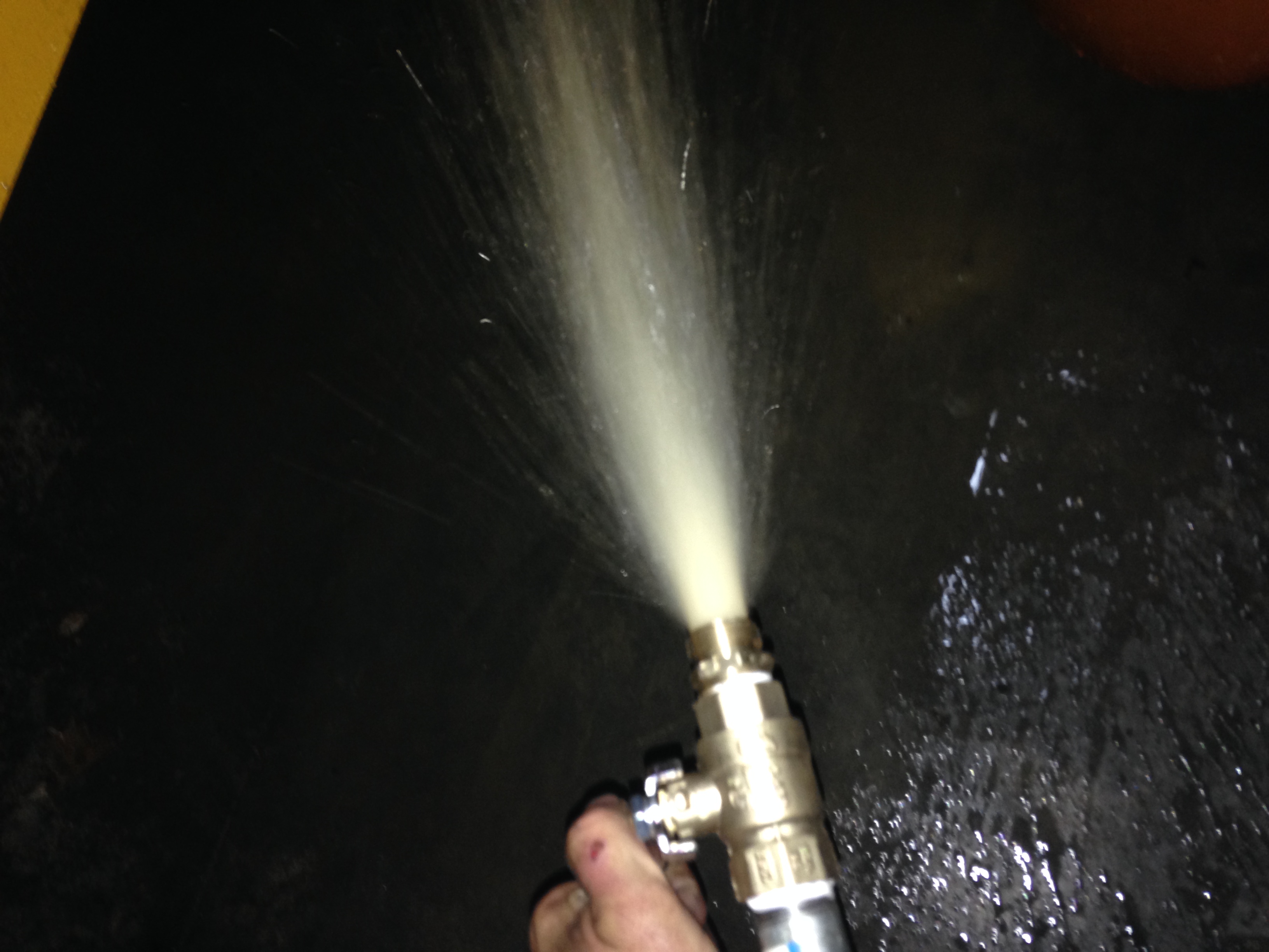

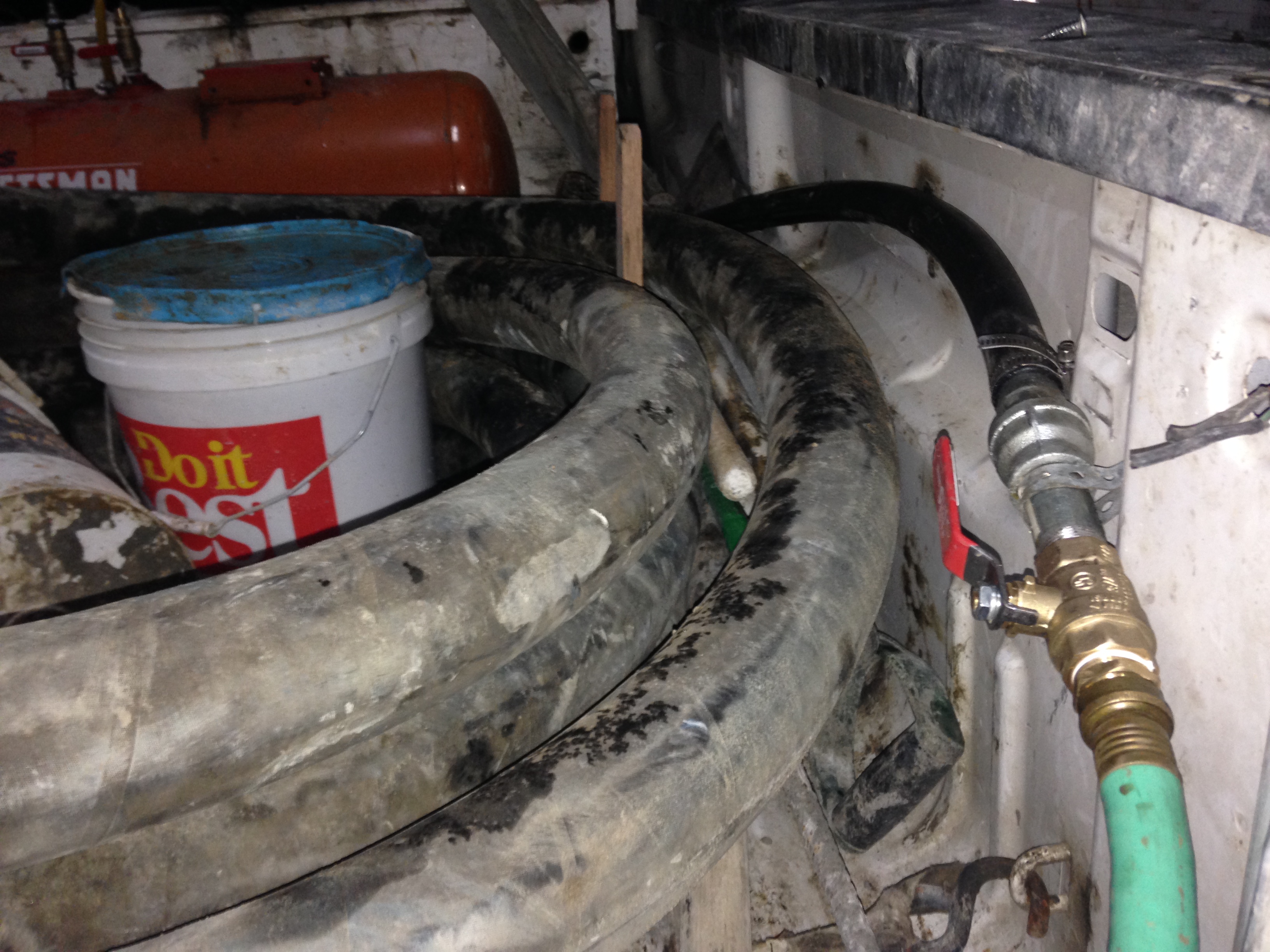

That looks like a really nice pump! Well today i put together and tried a compressed air tank water system. I got a free 25 gallon comp. tank and stripped it, then added air and water outlets. I put a 1" elbow on the bottom and fed the hose with 1" pipe. I used a 1/4" air hose to pressurize. WOW! it doesn't take much air or pressure to get great wash out water. Then i tried a small electric 120 volt tire inflator pump with very low air output. It also put out a good pressure. Now i am ordering a 12 volt air compressor for an alternate feed, so i don't have to run the gas motor. |
b-alto | 05-19-2015 | reply profile send pm notify |
I orderd a 12 volt compressor and mounted. it works well i get 35-40 psi continuous. if i need more pressure the gas can be fired up. I used it today. didn't need the gas. |
