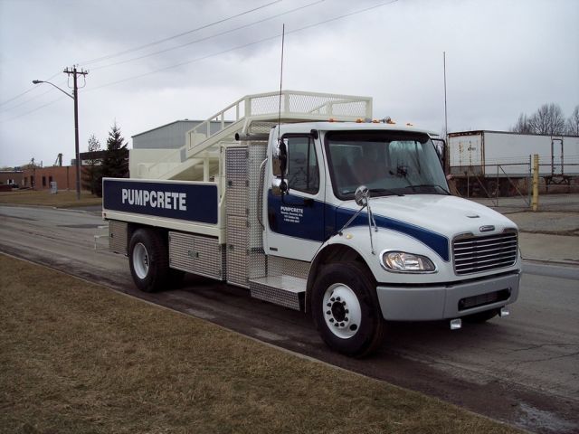

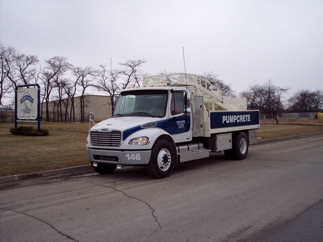

| Todd | 01-07-2012 | reply profile send pm notify |
| Pumperman430 | 01-07-2012 | reply profile send pm notify |
TODD, YOU ALWAYS GET THE BEST PICS. I REALLY LIKE THAT 1ST TRUCK. WE DON'T HAVE ANYTHING THAT NICE, BUT WHEN MY WIFE HAS TIME TO EITHER SHOW ME HOW... OR JUST POST SOME OF OUR WORK IN PROGRESS WE WILL. |

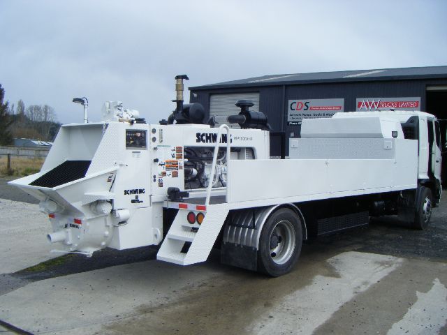

| kevcon | 01-07-2012 | reply profile send pm notify |
Ya that 1st one is what were aiming for. That's a nice compact unit. Looks like a schwing? |
Yep that's my friends pump, Ken jr. I can ask him about it if you want. Maybe he has some plans. |
Cool Todd. I really appreciate that 2nd post. Will help me out lots. I hope to shack hands with you at WOC 2012 |
| seedless | 01-07-2012 | reply profile send pm notify |
I like the pumpcrete unit also, you could have a quick change ramp stile unit, say crane it off to another truck, or have a trailer chassis for it, hmm incase you need a trailer only, we have rented trailer units for some tower jobs, crane bucket fed for small pours at any level of the tower. |

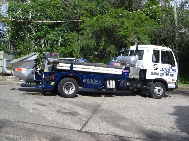

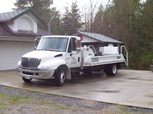

| woz | 01-08-2012 | reply profile send pm notify |
try building a Reed B-50 like this |
