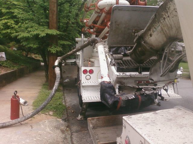

In the past couple months, a couple guys have posted that they have put a 90 at the top of the 6" - 5" reducer leading to the deck pipe, then go with the 5-4 and 4-3 reducers. Be sure you set your rear outriggers, so that your rig is stable when you lift the boom for access to the hopper. |

I too was impressed with the Too Tall shuffle pumping off the 6-5. Been doing it ever since. I can not believe I was taking the truck a part for years. What a waste of time! Last month I did 2 jobs in 4 hours with 80' of 3" system pumping off the reducer. It is genius and a time / labor saver! Thanks, TT |

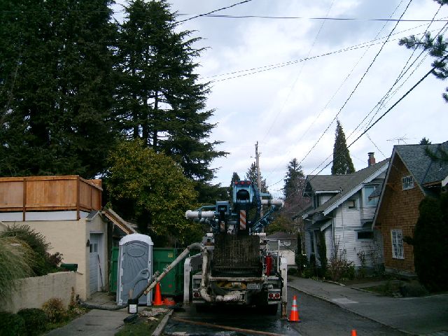

| TooTall | 05-29-2009 | reply profile send pm notify |
Pump On boys & girls, Every pump is a line pump! Had to line pump this job for obvious reasons. (wires!)

too tall ... nice to see you brought along a site office as well!! |
