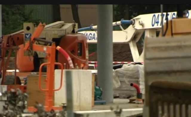

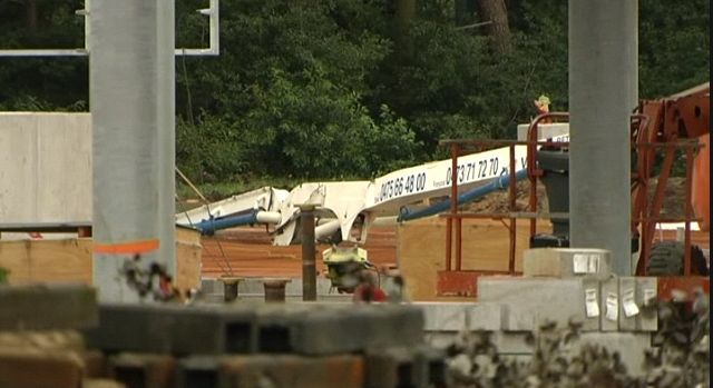

yesterday a 61 meter pump broke off an outrigger and killed two concrete placers on the spot.
investigation is still going on but nothing is coming out because it happend on prohiobited military domain.
no pictures were taken of the incident.
in the video hereunder of the belgian newssite taken from far you can see the the pump
www.deredactie.be/cm/vrtnieuws/regio/antwerpen/120914_Grobbendonk_arbeidsongeluk
i will post more if i know more

When an accident at the military domain in Grobbendonk two people were killed. On the Kool Earth Street workers were a crane to build, but there was a piece of the crane down. Two people were buried and are deceased. The parquet is en route to the scene of the accident.
view
Two killed in accident in Grobbendonk
"To a concrete floor pouring, the workers used a crane, concrete pump, which they concrete can produce. They were the crane drawing when one of the supports is broken. Then the crane overturned and two people buried beneath it hit, "said police chief Danny Fosselle.
"Two people were deceased, a third victim was taken to hospital."

I think Many used google translation. There was no crane involved in the accident, the police spokes men try to explain what kind of machine was used on the accident. The first thing that is being investigated is an outriggerThat appears to be broken of.

The last thing I have heard. And I say I heard it as a rumor that the back outrigger that also is the water tank was damaged by frost. And again I will say I heard it as a rumor.
