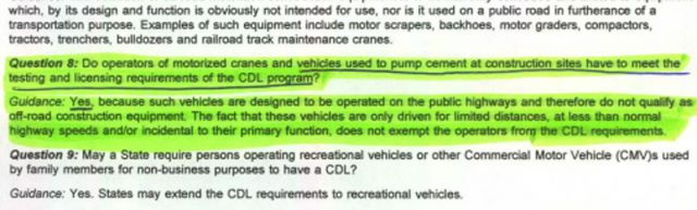

| Todd | 05-06-2013 | comment profile send pm notify |
See quetion number 8 |
| Mister_Perkins | 05-06-2013 | reply profile send pm notify |
What do some guys think they don't need a CDL to drive a concrete pump or mobile crane? |
| Todd | 05-06-2013 | reply profile send pm notify |
That ruling does not mean you need a CDL that ruling means you have to abide by the hours of service. This is a federal ruling. |
| caliber34 | 05-06-2013 | reply profile send pm notify |
I was just thinking about this yesterday, so for example if it was a 1 1/2 hr trip to the job site and you pumped for 13 hrs you would be out if hours, correct? So theoretically if you drive back and were involved an accident the operator could be held liable? Also does this require you to run a local log book? |

Quote:
If you are operating in intrastate commerce only and are not hauling hazardous materials requir
ing a placard, the Federal regulations do not apply to you |
Page 12 also lists exemptions for the Hours of Service regulations as well. Which most of us fall under the first listing which is if you are driving within a 100 air-mile radius (150 miles) you are exempt from keeping an H.O.S. .. Only requirement is to keep time track records ( time in, time out, and total hours ) |

CDL B required with tanker endoserment and current DOT med card. I have been stopped twice scales for a offroad fuel check. Pulled over for a permit inspection. Always have been asked for the lic. and med card. As far as the tanker endorsment goes michigan DOT says " any permanetly mounted tank 119 gallons or more" . If your running out of state with the pumps " the hours of service inter state "mite be a issue. Local jobs intra state they could care less. |
