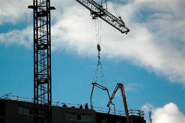

52putz | 08-02-2010 | comment profile send pm notify |
Ha! Cool pic. |
pumpjockey | 08-02-2010 | reply profile send pm notify |
I don't see much slack in the hose from the placing boom to the Texas Boom. Taken from that far back, are there safety slings? I think it should have been a longer placing boom, it's tying up a crane anyways. A mini-placer would have been the more professional solution. Given the rectangular foot print of the structure, a second location for the placing boom would be the ultimate, use one of the 2 cranes ('Texas Boom' holders) to fly it back and forth between pours. But obviously the engineer didn't even think about how the concrete would be placed. |
Many | 08-02-2010 | reply profile send pm notify |
Not an example of a safe pour,sorry |
Grinder101 | 08-02-2010 | reply profile send pm notify |
very cool. |
"MUDDY" | 08-02-2010 | reply profile send pm notify |
thats an example of getting it done with what you got. |
bigstick | 08-02-2010 | reply profile send pm notify |
It never ceases to amaze me that stupid people continue to do stupid things. As long as this stupidity continues, people will continue to get hurt and killed. |
getRdone | 08-02-2010 | reply profile send pm notify |
I guess thats one way to do it but why not just run hose on the deck are those guys that lazy. It only looked like 60ft???? |
ice | 08-02-2010 | reply profile send pm notify |
Good Job |
hey big stick... or should it be BIG MOUTH? you must be one of those miserable operators that smells like booze every morning on the job. keep up the good work. |
For your information there skippy, I very seldom drink, and I also have enough experience and common sense to not do dumb shit like whats in your picture. Some day maybe you'll learn something if you can read and comprehend safety, or maybe not? |
to pumpjockey and many..... i poured 25.. that's 25 floors in 10 1/2 months. the same way every floor. have you ever did anything like that? don't talk SAFETY to me. as far as tying up the crane to pour.. LOOK.. we were the only ones on the jobsite.. we pour the slabs at night (while you house slabbers are asleep) and the columns and shafts midday. |
yeah SKIPPY you sound real intelligent. you must be one of those house slab operators or maybe they stepped you up to block fill. which one is it? |
Weave | 08-02-2010 | reply profile send pm notify |
I don't think they want you to drag hoses across they're post tension cables. It get's special inspectors all worked up. |
pink panther | 08-02-2010 | reply profile send pm notify |
I believe the reason they are saying it is unsafe is because obviously the crane is taking some of the pipe weight off the deck. By looking at the pics, it looks like there is about 30 feet or so between the slings that is sagging and causes alot of pressure on the clamps in the middle. So technically, it is unsafe. |
we used bolt on clamps on the pipe. i can take criticism if it is done the right way. thats the way you do it PINK PANTHER. you sound like good management material. |
Yeah, thanks 'MUDDY', you're my friggin' hero now. NOT!!
Thanks "MUDDY" I would not want any management position, I love operating a pump and do not believe I would stop to take a position like that. |
you read my mind PUMPDONKEY. that's what i thought about you. |
Wow, everybody look at me, I can do a completely unsafe job and have the balls to try to convence everybody its ok to do dumb shit on a regular basis. I dont care what you do. however there are alot of young operators on here, and I dont think bragging about doing something stupid is a very good thing for them to see.
Bigstick, you are right, that is not the safest way to do it. I have always used saucers under the clamps and then plywood on the deck to help slide the pans. That is the best way I know of besides another tower for the boom. Muddy, the bolts can break, especially with the amount of force that the clamp is under in that situation. |

Pump N00b | 08-03-2010 | reply profile send pm notify |
Get a bigger boom! |
Many | 08-03-2010 | reply profile send pm notify |
Stick You said you were going to be good,imagine that.I can see we have an engineer in our midst.I can also see where another mast and boom would be in order.Perhaps he should send that pic to the manufacturer and acpa for there opinion. |
bigstick | 08-03-2010 | reply profile send pm notify |
Well Many, you know as well as I do this is NOT safe. You said it first. You are alot like me, when we see something wrong, we try to inform less experienced people that this kind of stuff dont fly. The fact is there are almost 4000 members on here, and probaly several thousand more lurkers. When some guys see people doing things like this they think its ok. Hooking a boom to a hundred feet of pipe and suspending in the air will never be safe or accepted by the ACPA. Muddy, I wish you all the best, and I hope your owner has lots and lots of liability insurance, because someday he will need it. |
jj707 | 08-03-2010 | reply profile send pm notify |
it is unsafe anyway you look at it, hell a texas boom rig isnt a accepted practice and it has a i-beam to add support for the pipe so the pump never sees it, this is stupid, the easiest way isnt always the best way, so "MUDDY" you keep getn her done on somebody elses future scrap metal you keep posting crap like that and when you lose the job you have it will be awful hard to find another one, you seem like one of those guys who speaks and post pics without thinking and doing stupid shit on jobs before you weigh the damages that could occur, but hey its not my iron so f#ck it up theres plenty used shit out there you can find. |
Wildbill83 | 08-03-2010 | reply profile send pm notify |
Big stick, i agree with you....I was forced to use one of those by a contractor in Phoenix years back. It was built by a reputable pump company here. The crane company and operators wouldn't even use it at first. They use the pump to control it, and one pour it hit the deck and shot off it when it plugged. One time it plugged on prime and blew the piping right off the 61m. I eventually left pumping(after 10 years) mainly cause of that job. We were certified but that didnt seem to matter what i said. Hopefully the industry and OSHA will grow some ***** and stop this crap. |
Todd | 08-03-2010 | reply profile send pm notify |
I do not believe this is an opportunity for any of us to be disrespectful to Muddy. Cant we talk about this and be nice and professional? Lets see what my safety guy says about this. Oh and Muddy thanks for posting this so we can talk about it. |
dlee7729 | 08-03-2010 | reply profile send pm notify |
Why not use a mini placer? From the looks of the pics with the boom extend out you can reach half the pour. I can see you don't want to lay system down on the post tension. But you are using a expensive tower crane to do something that can be avoided. Not to say when you have a plug and all that pipe starts wiping around hanging there. Why not start the pour with the boom so finishers have access then hook into the mini placer where you can't reach and finish it out with the boom? That way the tower crane is free to do his thing and you only need one pick. |
zuat150 | 08-03-2010 | reply profile send pm notify |
"MUDDY" "to pumpjockey and many..... i poured 25.. that's 25 floors in 10 1/2 months. the same way every floor. have you ever did anything like that? don't talk SAFETY to me. as far as tying up the crane to pour.. LOOK.. we were the only ones on the jobsite.. we pour the slabs at night (while you house slabbers are asleep) and the columns and shafts midday." Tell me more please.. |
This is commonly known as using a 'superboom' in most of the U.S.
It is forbidden by the pump manufacturers and the crane manufacturers.
Experience has taught us that there are hundreds of cracks that appear in the crane after doing a building where they used superbooms on each floor. Furthermore, the crane is run by one person and the placing boom by another. If their communications fail or one operator makes the wrong move for even a moment, the crane, the placing boom, or both, come crashing down.
Absolutely dangerous, absolutely forbidden. Its just a matter of time until somebody dies doing it. |
explain the difference between this and a '50 trimmy for caisons |
"MUDDY" | 08-03-2010 | reply profile send pm notify |
thats an acceptable answer Todd. (in a perfect world) but try telling that to a contractor or company owner. if you don't do there is somebody out there that will. |
thats an acceptable answer Todd. (in a perfect world) but try telling that to a contractor or company owner. if you don't do there is somebody out there that will. My only point here is it should have been discussed way before starting,by your office.All to many times the operator get caught in the middle,I agree.This should have never happend,a second mast and boom would have been a better call.These are the type things that get people hurt. Keep in mind if you will,most of the time damage happens it doesn't show it's ugly face till much later.I pray a boom failure never happens to you,a life changing moment for sure. |
pink panther | 08-03-2010 | reply profile send pm notify |
Muddy, you can't be forced to do something that is unsafe and if you lose your job because you want to be safe, then you are better off not working for a company that operates that way. In due time that company will not be in business after the lawsuits that will come from a disaster that could have been avoided instead of trying to do it the cheapest and easiest way. Keep that in mind when you do another unsafe pour. |
I see now who you work for. I thought they were out of business? Is Nathan still the boss there?
Slinger488 | 08-03-2010 | reply profile send pm notify |
I cant beleive the crane operator agree'd. I bet a plug and release will change his way of thinking |
I just have to ask. Do you actually run all of those pumps or do you get pictures from other people because all of your pics have different pumps. Just curious |
all of the pictures i send out are of jobs i have been on. |
hey bigstick. nathan left that company. he works for cross in biloxi now. since you know the company maybe you can comprehend what the operators go thru on a day to day basis. it was actually terrible. |
I could not stay there but about six months. Way too much cowboys and heros for me. Saw alot of crazy stuff going on. Not for me. Seriously, good luck, just be careful. I know everybody is just trying to feed thier kids right now. And it is tough. |
