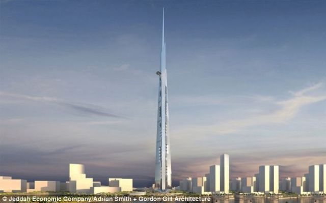

'We need to pump concrete half a MILE into the sky"
Todd 02-27-2014
  • The Kingdom Tower will measure 3,280ft (1km) tall if it is built in Jeddah, Saudi Arabia to provide views of the Red Sea
  • Foundations will be 200metres deep and able to withstand salt of Red Sea
  • Engineers are currently testing materials, such as concrete and steel, out of which the massive skyscraper could be constructed
  • Once of the biggest challenges is the pouring of concrete thousands of feet off the ground - and a thin pressurised tube could be the answer
Read more: http://www.dailymail.co.uk/sciencetech/article-2567458/We-need-pump-concrete-half-MILE-sky-Engineers-puzzled-build-worlds-tallest-building.html#ixzz2uWfVO4yf
Follow us: @MailOnline on Twitter | DailyMail on Facebook
