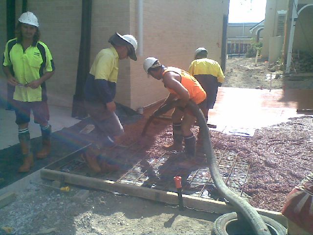

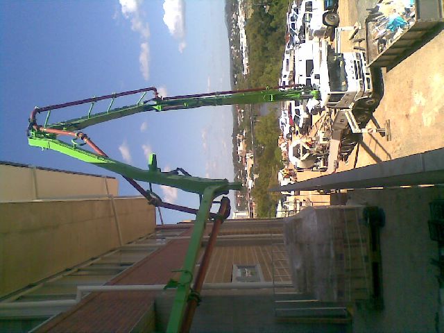

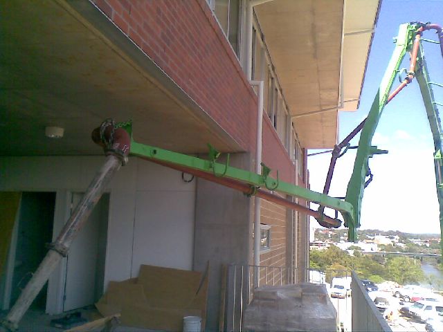

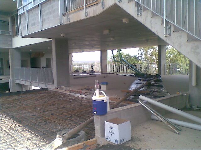

| Drew AUS | 03-26-2009 | reply profile send pm notify |
Nice pics mate looks like a pretty good job! Is that a daewoo 36 or 40 , it looks a lot like an antonelli 40m with 280 degrees on the 4th stage, great boom |
| pumpinbear | 03-27-2009 | reply profile send pm notify |
its a daewoo 36 mate and the guy that owns it dosnt like spending money on it and its not in real good nick but it pumps well and im getting paid so what dp u do i guess/. |
| Theo | 03-27-2009 | reply profile send pm notify |
when you pump with your boom up then down and into line how do you prime? I always plug up in the first or second section of line |
I just use a couple of bags of cement and mix a good slurry and then push it through slow. The concrete that we used that day was exposed agregate like pebble crete and it went through ok. I also put some slurry in the end of the hose and roll it back through the hose b4 we start. |
