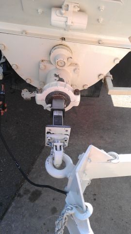

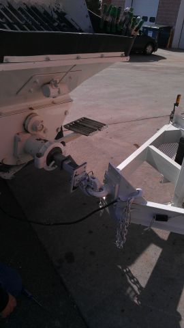

I came accross this today I am not sure if its a good or bad idea although the workmanship was very good.

I think it's innovative, but a collosal bad idea.  It removes a lot of tongue weight on the lead trailer.  It may pull OK untill you hit some bunps in the road that 'teeter-totter' the pumps and in turn lift the tow vehicle and you lose control.  (I wonder how I know that?  - Suffice it to say, there was a lot of tire creeching going on and some white knuckles until it all settled down - 'NUFF SED!)  No more double-towing for me!!

One major prob. with this unit Is the the hopper mount to the frame. I would hate to see that trailer being pull down the road by only the hydro. hoses. because your pump kit was yanked out from between the frame. Looks clean though.

I guess it should be aproved by some kind of legal road institution before you can use it legaly.. At one hand you would think if it can stand 80 bars it should be stroung enough.. At the other hand the forces will hit it in a totaly different way than normal. I would not do it if it was me..

I have to agree with Pumpjockey. Tried loading hopper and towing and nearly wrecked. Tandem on pump might be answer.

I towed mt B50 with mud in the hopper, there was a diference in how it handled, but not like when I had another trailer behind.  I welded a receiver hitch tube to the hopper under the outlet.  Bumps in the road and speed were the difference, especially speed.  Reciever was handy for getting towed out backwards, though.  I'd never tow anything (heavy) behind a pump, especially a single axle pump chassis, maybe a small wheeled cement or mortar mixer if it was a special job, but I'd take it slow.  The 'invention' as pictured is not how I'd do it.

A truck-mount would handle much better, but I still don't liken tthe idea of how this mechanism stresses the outlet, nevermind the mounting points of the hopper.
When I welded the reciever on my B50, I was very satisfied with the stucture of how the hopper was mounted to the trailer chassis.  The being said, an engineer would likely have a different opinion.
This is much like using a boom as a crane, that/this was not the intended and designed purpose.

I agree with you "pumpjockey". Why not in some how make the trailer to be conected in to the chassie instead? Much safer and better, in my opinion.
