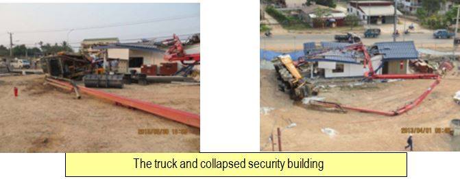

What happen? why did the concrete pump flip over?
Todd 05-23-2016
WHAT HAPPENED?
Approximately at 4:45 pm the concrete pump truck operator had completed the day’s works and was
instructed to start the cleaning activities on the concrete pump truck before transporting the pump back to the
supplier’s yard. Shortly following this, the same subcontractors technician instructed the pump operator to
prepare for another job, where following he lowered the boom and retracted the outriggers ready to move to
the next project.
It was at this time that the same technician returned and informed the pump operator that the proposed job
had been cancelled. The pump operator re-extended the boom but had forgotten to re-engage the
outriggers.
This resulted in the truck becoming unbalanced and caused the truck to topple over on its right side
damaging the decommissioned temporary security building which was located parallel to it.
There were no personnel located inside or surrounding the truck during the incident.
CAUSES OF EVENT:
Contractor management – human error by the pump operator
Change management – change in instruction from the suppliers technician contributed to the incident
Operating authority error or violation-the operator failed to re-engage the outriggers as a standard
operating procedure when raising the boom
CORRECTIVE ACTIONS:
Ensure supervision is present at all times during sub-contracted works
Ensure all operators are assessed as competent prior to operating any plant or equipment
Ensure a risk assessment for the task is carried out prior to commencing any new activity
RELEVANT LEGISLATION:
Construction Regulation 21 Construction vehicles and mobile plant.—(1) A contractor shall ensure that all
construction vehicles and mobile plants (c) are used in accordance with their design and the intention for
which they were designed; (d) are operated by workers

Change of routine is a common cause of accidents , I had a 30 year veteran do the same thing a couple years back , me and our safety department preaches double and triple checking yourself , especially when you have gotten out of routine.

Todd, from my experience. The operator raised the boom out of the cradle and started cleaning the hopper. The remote moved some and jammed a joy stick or two and the boom unfolded, tipping over.
I think it was 2004. I had a operator running a old 875 Thompson for me. He was cleaning it out and and the remote cord got into his way. He threw the remote up and out of his was, but the remote cord landed on the pony motor's exhaust. The exhaust burned through the cord. The boom then started to raise and went right into the cab of the truck causing all kinds of damage. He turned the pump off and called me. He didn't know what happened until I got looking at everything.
