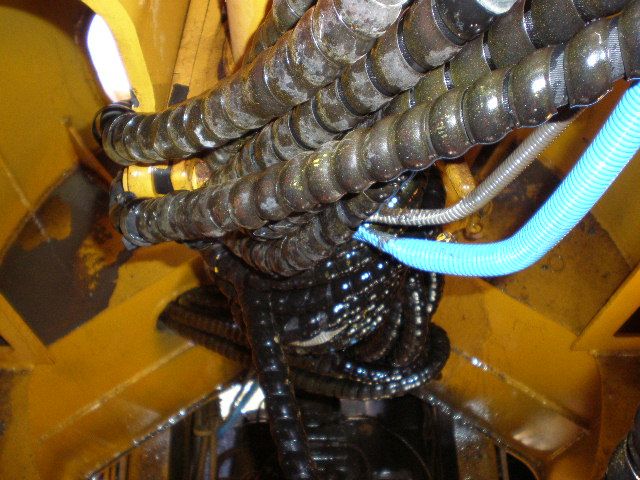

I went out to repair a pump that had a leak in the turret and this is what I found when I showed the owner and exspained how he asked me what should he do |

I don't know, Fish. One thing for sure, he doesn't have his head in the game. |

Hmm correct me if im wrong but it looks like the opertor pays no attention to the side he closed up on the day before (Thats what i can make out ).. Simple either sack the bum , kick your own arse for no educating him or put a blocker on your slew ring .... |

well, my policy in the past is to first find out if the turett signal or anti-rotate device was working properly(if equipped with one). If it has one and wasnt working then the operator has a legitimante excuse. If it doesnt have one then the operator made a mistake and i get the operator to go in the turett aand do the dirty work to help him/her remember the mistake. Has worked well for me over the years. |

What the hell is it? |
Bob | 03-12-2009 | reply profile send pm notify |
It is the result of........ when running a boom with a center bearing [big 'Rotec' style turret] with the boom hoses in the center......... if you don't really care about the machine, the customer or the company you work for......... just swing the boom without first glancing down in the turret and seeing which way the hoses are wrapped. For a guy that is used to running a boom with a rack and pinion [like yours] where the hoses are on the outside, well, this kind of thing could happen. But a guy that runs one of these machines on a regular basis - THIS IS A DUMB-ASS STUNT! It takes less than 60 seconds to check, and more than an hour to fix. OH, and don't forget the cost of all of the new hoses. MOST, not all, companies that run this style turret have ALL of the operators ALL of the time fold them back up over the same side ALWAYS. I wonder what the company policy was at this company? I wonder what it will be on Monday? ;~) |

well guys today I found out that some one hammerd over the swing stop so it would not set off the horn and as we all know no one did it |

Those limit switches are a joke. You could be up there washing your pump and flick it to the other side of the stop block very easily. Check - verify. 30 seconds |

Bob I agree that the limitsiwtch devices or signals do not replace proper operator trainig and shouild never be incorperated into operator safety training. However remember that rack and pinion by nature of desgn cannot go too far the wrong way, therefore i think to say limit swtches are a "joke " is a little harsh. They are operating "aid" and not a failsafe.That being said i still agree that you can never underestimate the power if laziness. |

You are right. I should have said; to rely on them is foolish. ;~) |
