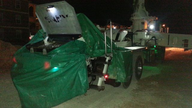

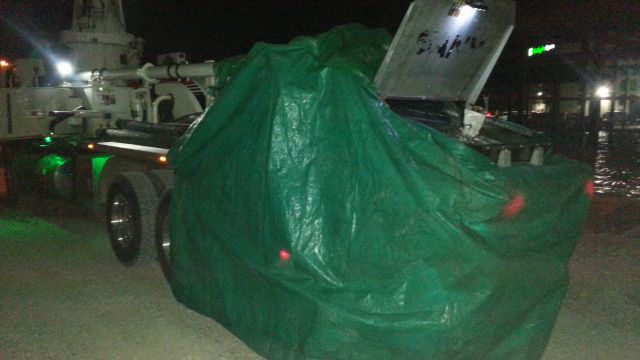

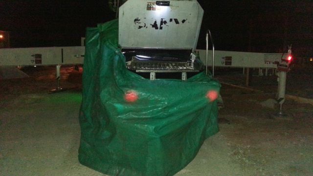

yard whore | 10-18-2013 | reply profile send pm notify |
Tarp your truck each and every pour....no concrete to clean at all. Simple and cheep. |
Yep...that too. Scotch Brites and Dawn make a good combo. |
